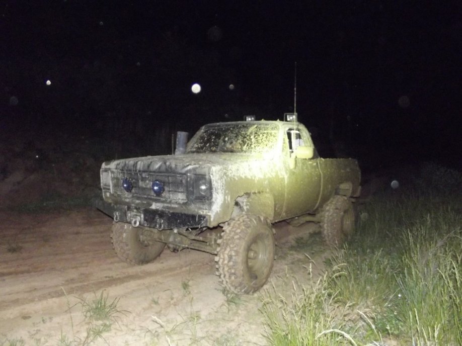

12.5 wide TSLs on 10" wide wheels with standard offset stick out just a couple inches if you wanted to keep the heat off you in your area. That's on a Dana 60 front though, I think there may be a slight difference in WMS width compared to 1/2 and 3/4 ton fronts.
