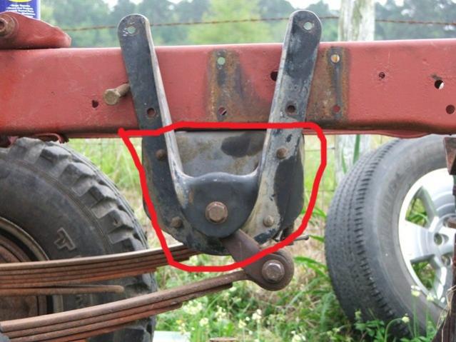

you could use a 4x4 shackle but i would cut off the top and drill out the rivits and just use the 4 bottom holes to bolt it to the frame

Two wheel drive spring hanger I used on the rear of my truck.

What doese using a 2 wheel drive bracket do to help

the 2 wheel drive bracket is shorter and does not hang as low as a 4x4 mount
if you want more lift cut your front hangers off and space them down 2' or so with a peice of square tube then redrill the mounting holes
then use 2 wheel drive brackets on the rear for the shackle flip

Not the ideal way to do things, as the tube can crush under side loads. A simple angle bracket with beefy gussets would work better.
