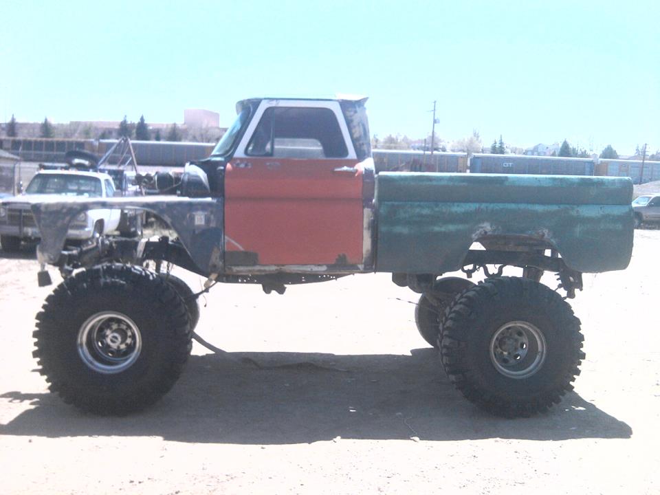

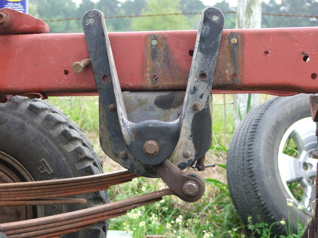

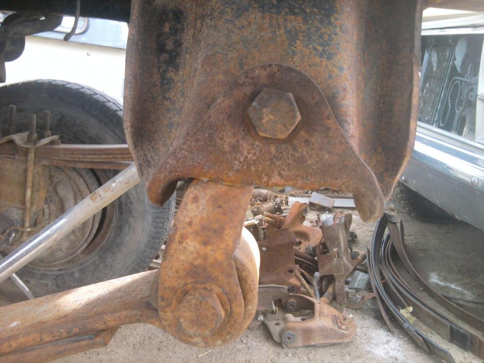

i temp done it on my mud truck just to get the back to match the front
12'' front springs
stock blazer rear springs 6'' block and the home grown shackle flip
i do not like it i would never run it like that
shacle flip gave that truck right around 4''
i have taken 2 wheel drive truck hangers off the front of the rear springs and used them and liked it that way

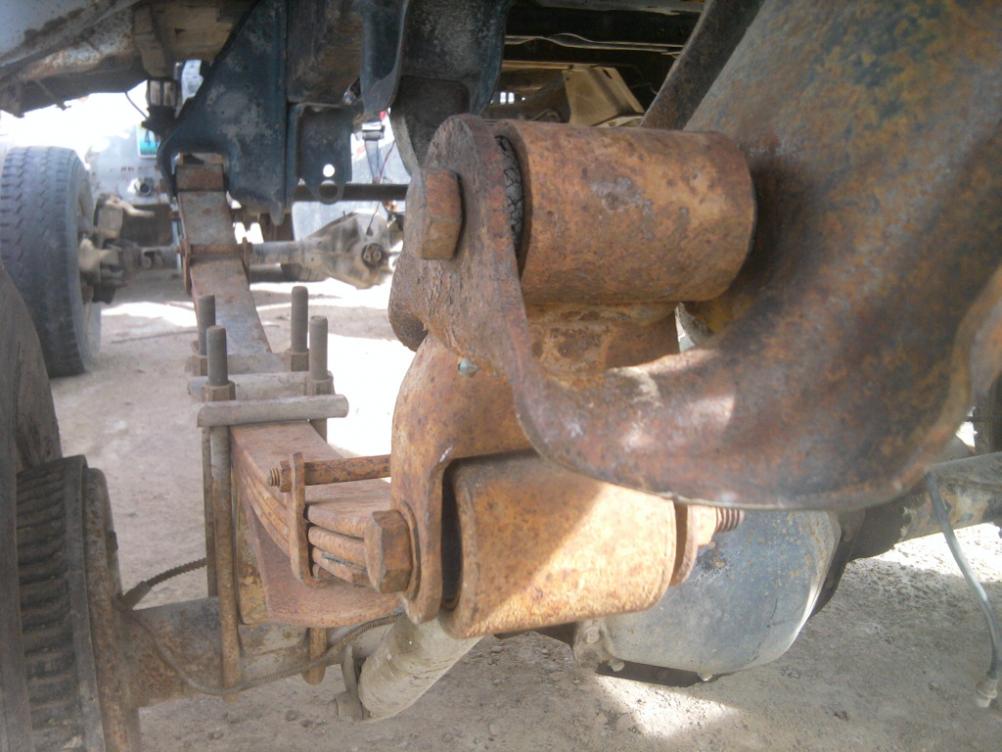

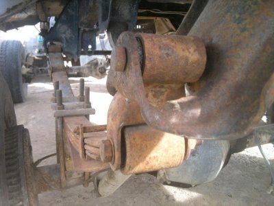

the 2 wheel drive chevy trucks have a sorter front hanger bracket then the 4x4
i have used them for a rear shackle flip
i the picture this guy did it with a 4x4 front spring hangar but i liked the 2 wheel drive one
