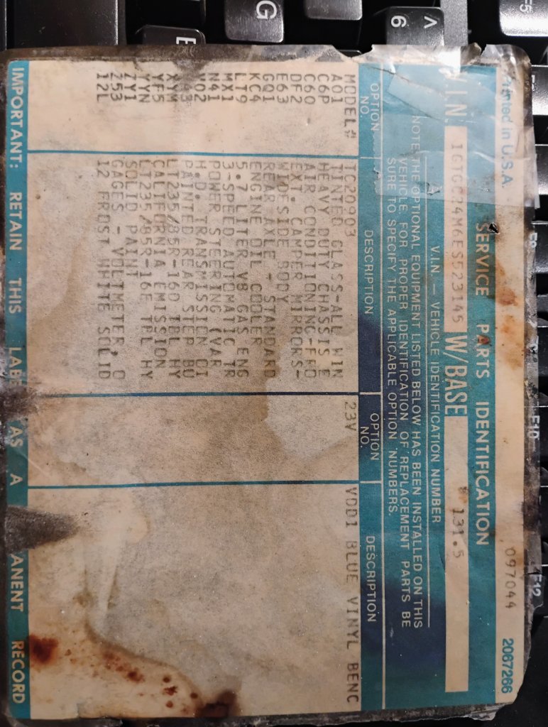

This is the only pic I have ATM. Went to get a current/better one but I believe its stored inside the sand blasted cab which is wrapped up tight with a tarp for winter. Not sure if they slapped these over top other labels as mine is - my box was butchered for a dealer installed AC setup - so maybe it was moved for that?
Its getting removed and re-popped anyways so it reflects its actual paint colors and updated options.
