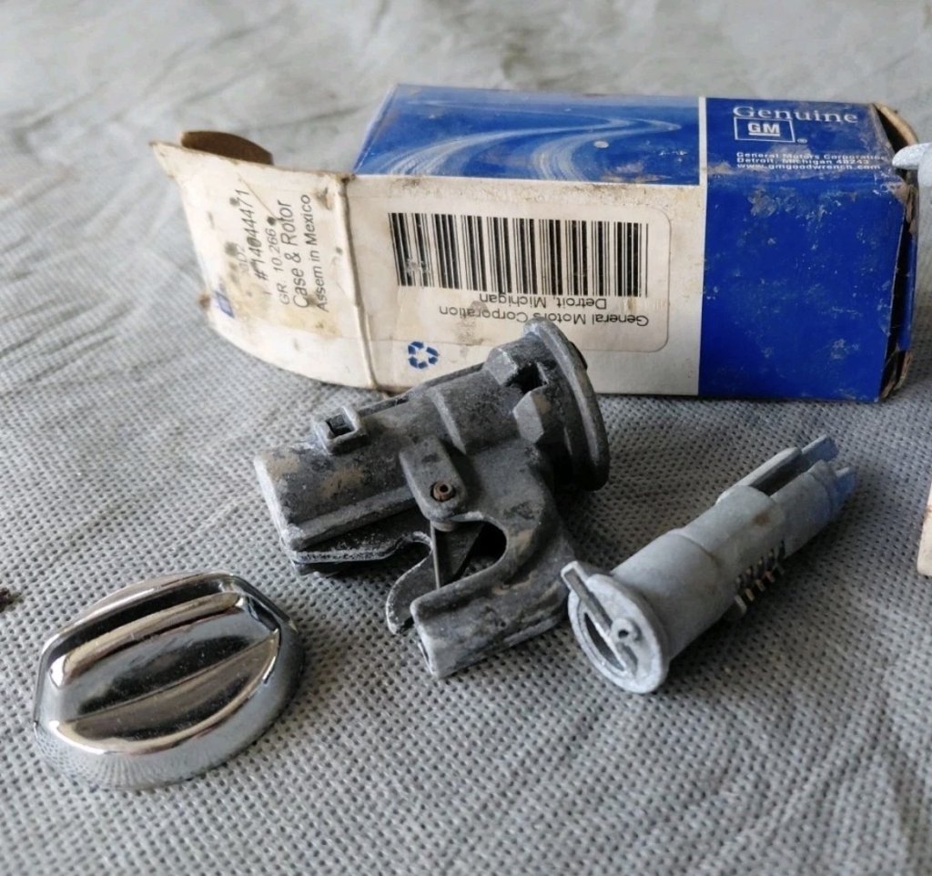

My two cents ... If you are discussing a truck, I cannot advise what came with locking or not locking gloveboxes.
My 85 Blazer (Im the original owner) the Console between the seats locked and the glovebox did not lock.
I did however, locate an unkeyed cylinder to install and have keyed to match the Door and Center Console so that I could lock my glovebox.
When I spoke to the Lock technican about installing the clyinders into the receivers, he advised me to make sure the receivers were in the locked Position before inserting the cylinder into the receiver. This way you would use the key to just turn and it would be unlocked and ready to be used.

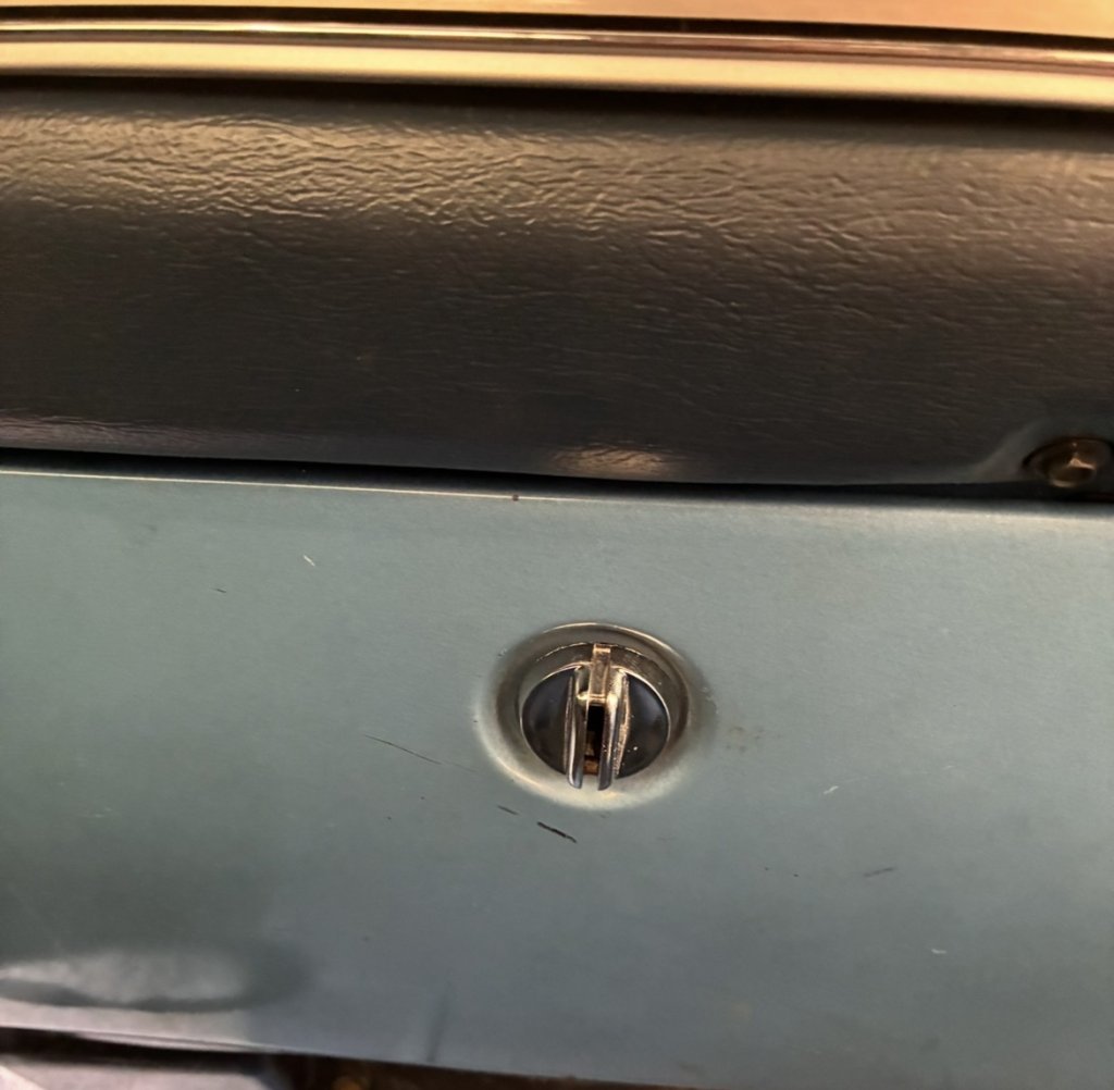

In looking at your picture, is the glovebox installed in the dash ?
You should be able to remove the cylinder again my using a pick on the open side of the receiver near the glove box and depressing the internal pins that hold the cylinder in place.
If you have troubles, take the whole thing down to a quality locksmith and have them remove and reinstall.

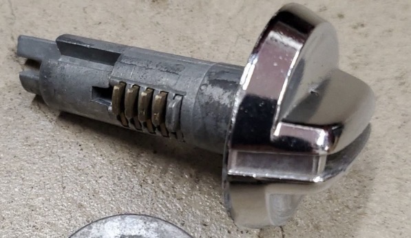

Got it back from the locksmith. The door key I was trying to use was correct, but due to the wear it wouldn't work on the FACTORY ORIGINAL glove box lock. He made a new key using the lock cylinder, bam back in business. On to the next 534 things...
