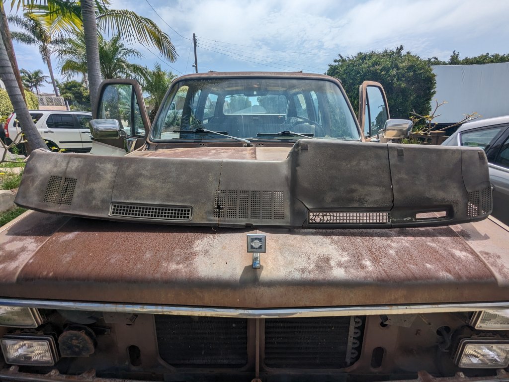

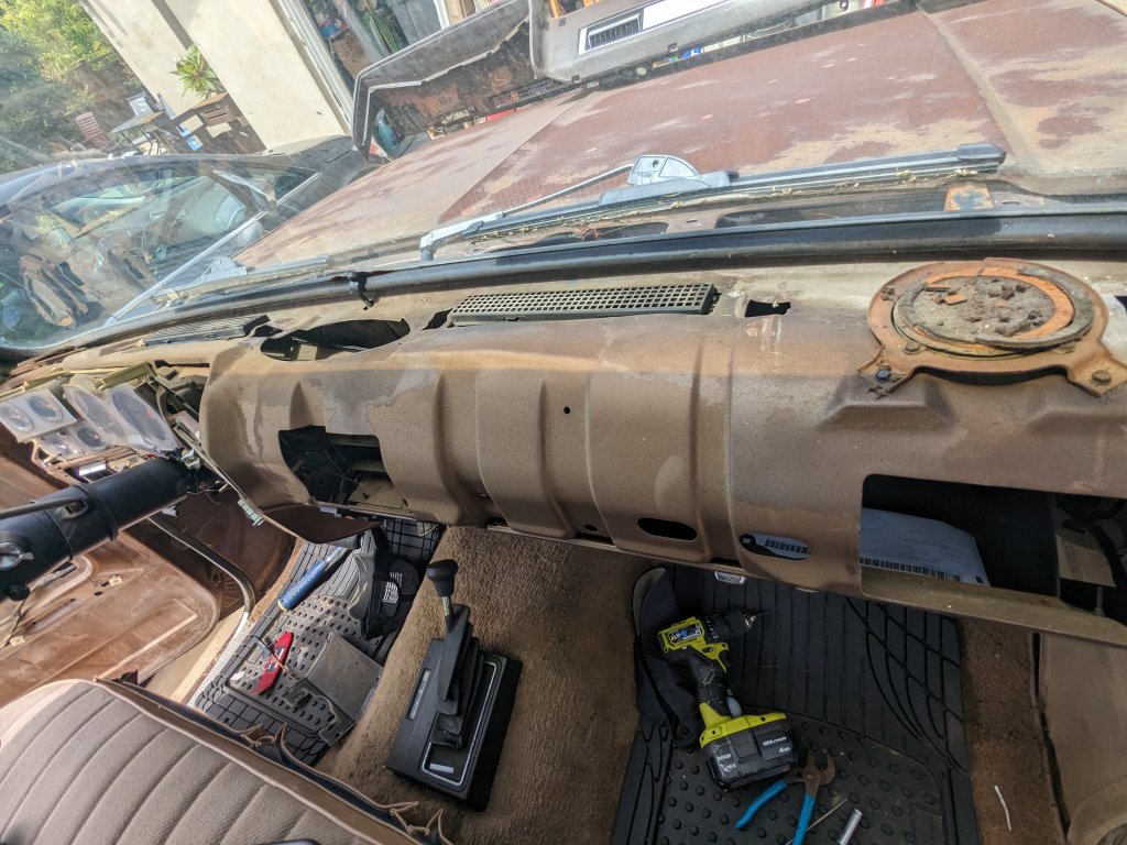

Here is what I have in the dash and the pad..its got a cutout for (1) 4x10, (2) 3.5 but no center speaker was installed

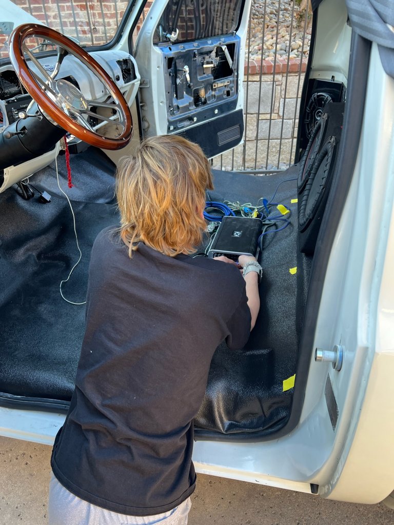

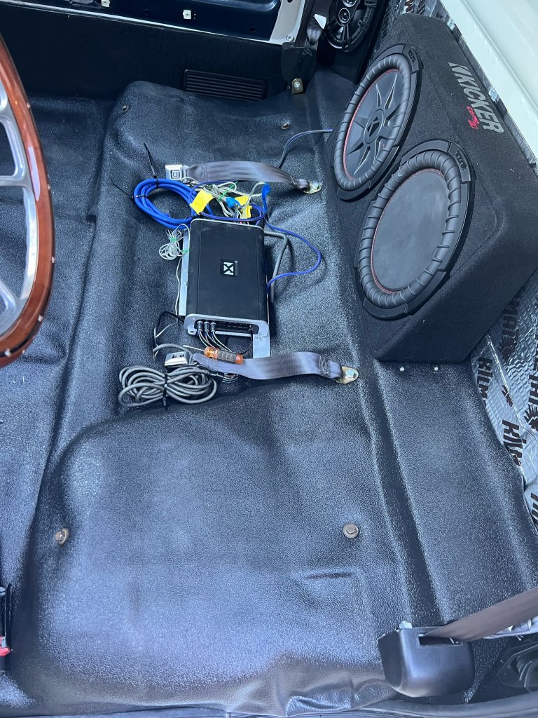

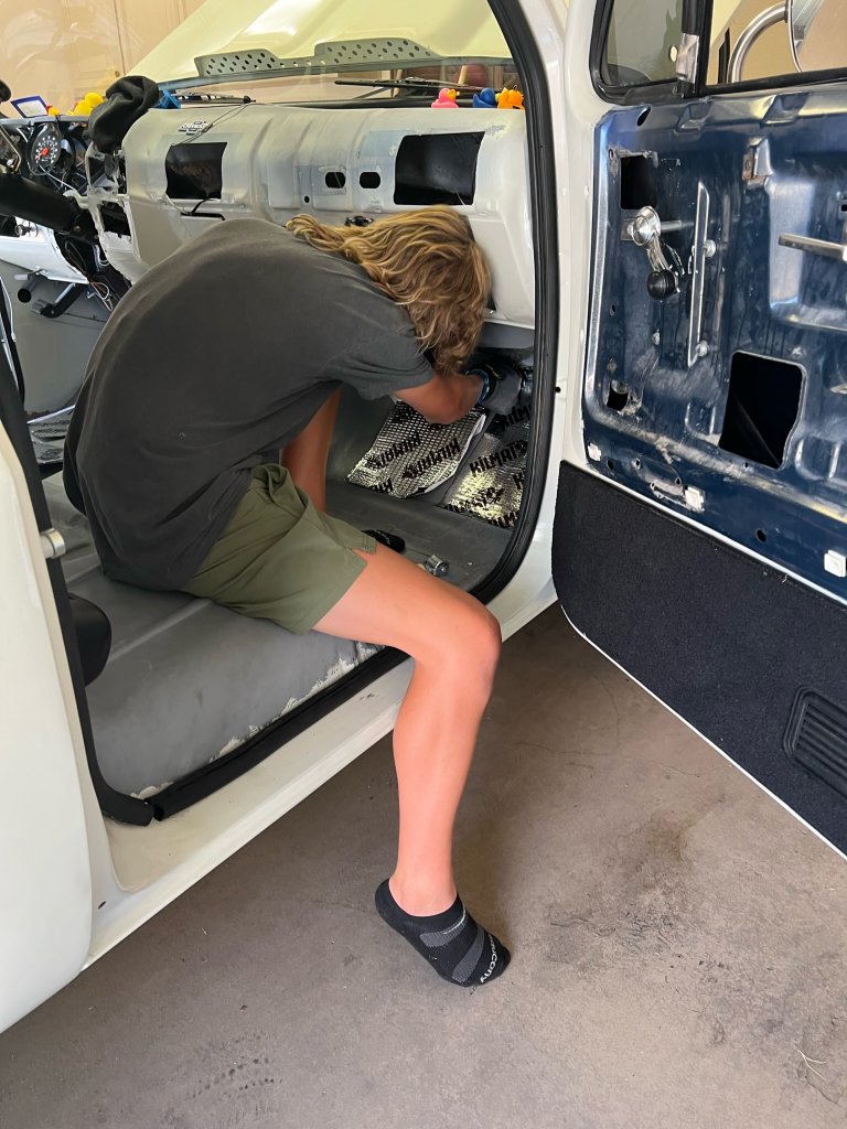

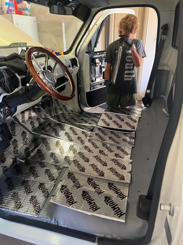

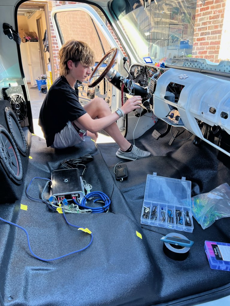

@scenic760 , imagination and funds is the limit with this stuff. When Easton wanted to do stereo I took a backseat. He spent 1K on amazon and got a great system that we can hear when he drives in the neighborhood. Never understood 1500 watt amp for a standard cab truck but what do dads know anyway. He put dual Chanel speaker in dash and just 6X9’s behind the seat and the enormous sub behind seat. He loves it !

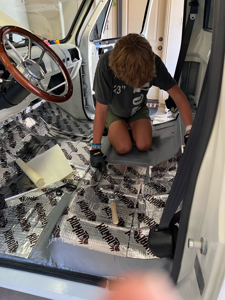

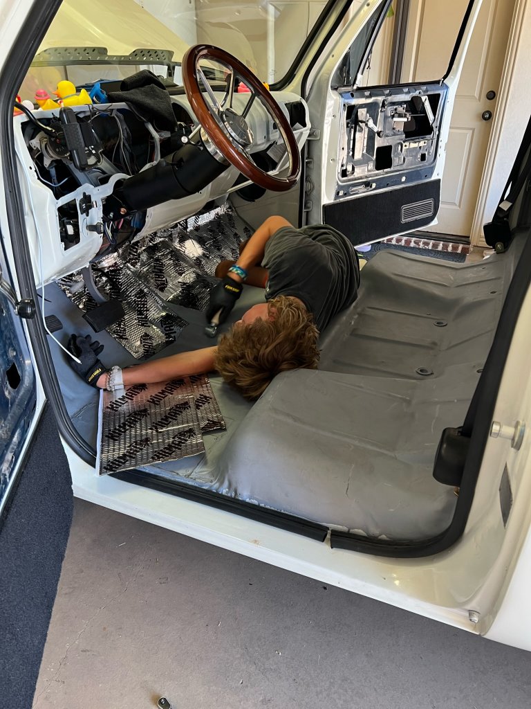

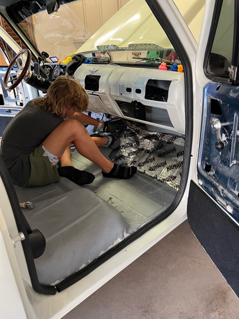

That's a pretty clean install! It looks like he laid Kilmat all over too? Although with a 1500w amp and that sub, I'm not sure you would need to overcome a whole lot of road noise, haha

Yeah he did it in doors and everywhere. But you’re right “what road noise”!

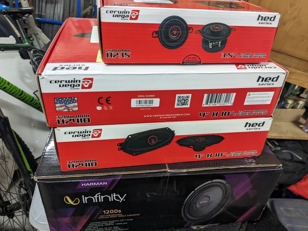

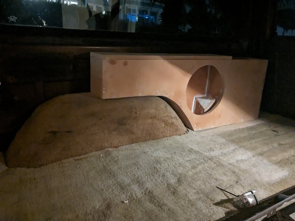

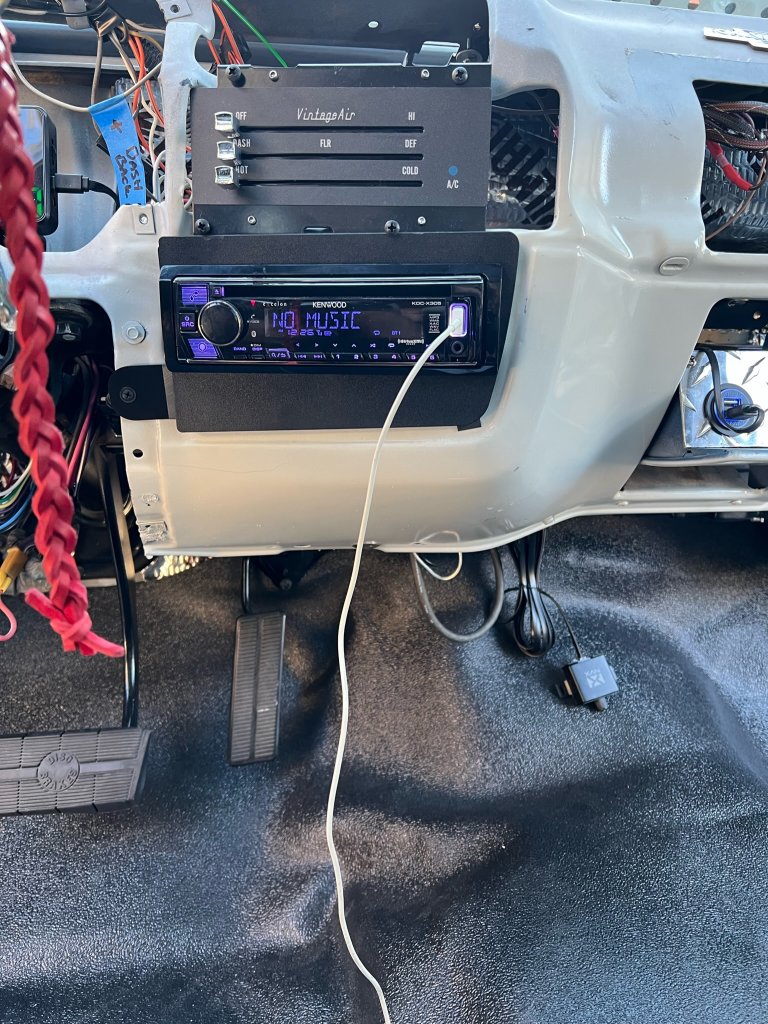

Alrighty...here is what I'm going to give it a shot with...I'm going to stick with the 4x10 size in the center and rear, put 3.5" in the dash and a custom sealed box for a shallow mount 12" sub...everything is a bit rough at the moment
Pioneer the best way to go on the head unit? I was looking at their component units and it looks like it would solve a lot of problems?
