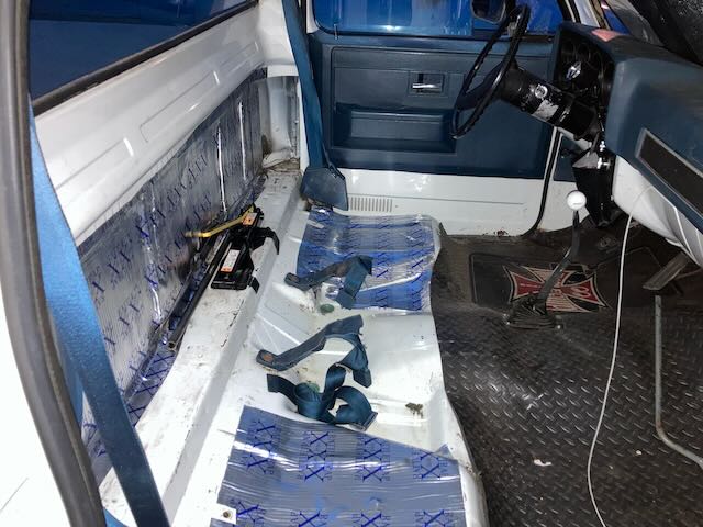

So, while I was recovering my seat, in my standard Pickemup, I laid down sound insulation on the back and under the seats as shown, only. This slight change was dramatic in how it quieted the interior. Nothing in the doors, nothing on the ceiling (its a solid metal cab top), nothing under the rubber diamond plate floor ($38 from the homely depot). It drives like a new truck and amazingly quiet.

Helped a lot in my truck. The ceiling helps with rain noise. Do the doors too
