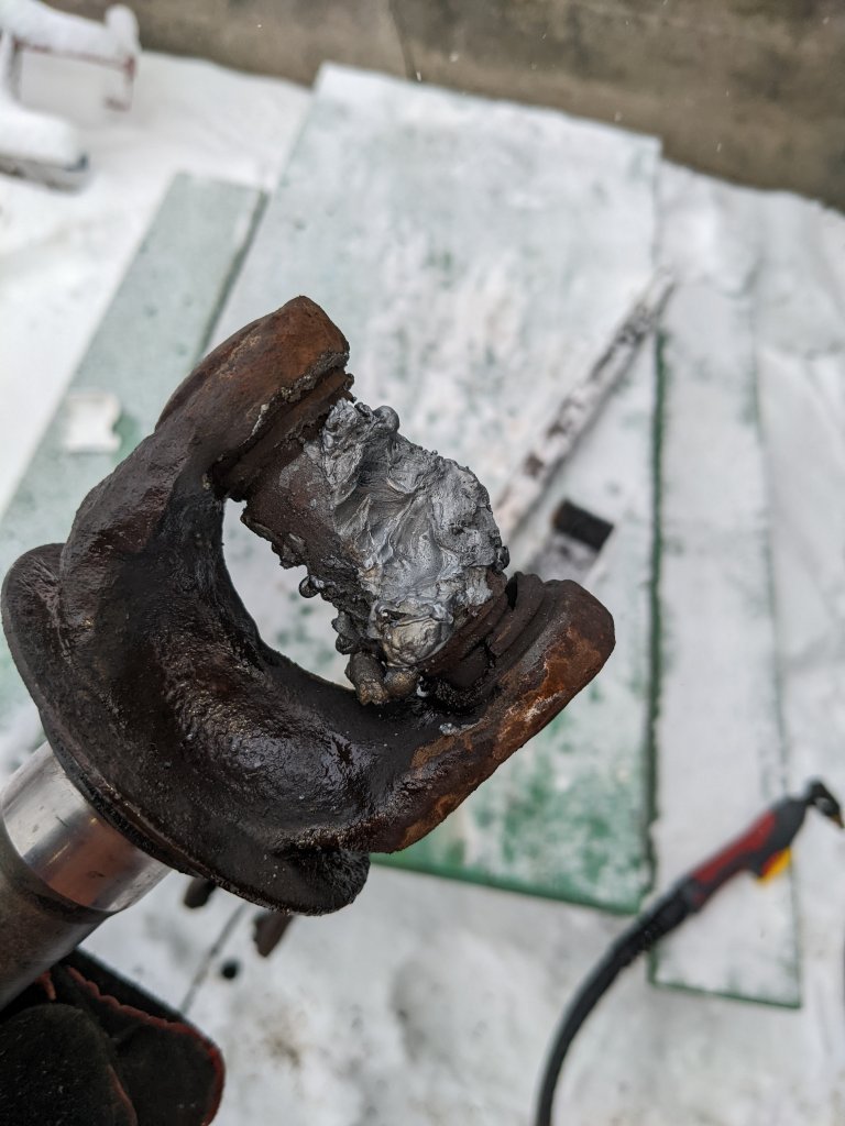

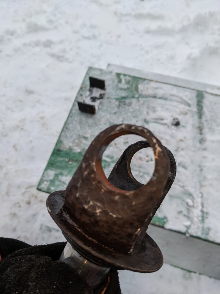

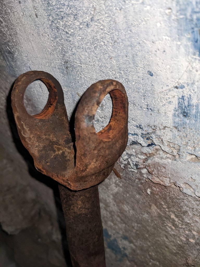

success! plasma cutter to the rescue even burned the caps through the center and either it was the heat or i weakend them enough but after that they popped right out. new u joint is installed and i realized after I installed it that Napa must have gave me the wrong one because the caps stick out ever so slightly i know they will get hung up on the knuckle going back in i may have to grind the nuckle or the caps a bit but wtf anyways 1 job done thanks for the suggestions guys

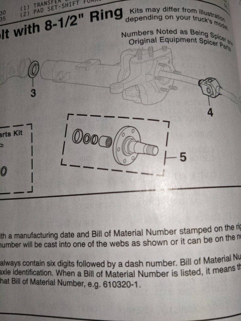

kinda late to the party with this one but ive got one last question for you guys....is there a bearing inside the spindle? i can see no sign of one left but looking at an lmc truck catalog i see a diagram showing parts im missing....

kinda late to the party with this one but ive got one last question for you guys....is there a bearing inside the spindle? i can see no sign of one left but looking at an lmc truck catalog i see a diagram showing parts im missing.... whoops sorry double post

Yes. There is.
