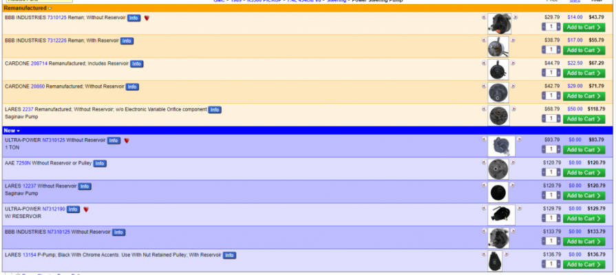

im replacing my power steering pump and was wondering should i go reman or new and are any of these any good? also my truck has hydro boost and the remote reservoir if that helps any.

would you recommend any good brands or any of the new brands on the rockauto page i attached?
Sure. From that list I'd get the Lares unit with the reservoir. It's up to you if you want to go with or without reservoir, but I perfer with because it's easier. The biggest issue with reusing the old reservoir is you have to be very careful not to bend it when your separating it from the pump, and very careful you don't snag the O-ring or push it out of place when reinstalling. And of course a mistake there requires pulling the pump back off.

i wish that one would work since it would make it easier but i cant use that one it has the wrong reservoir and wrong pully mounting type.
Ok, Well then I'll give you my opinion on all the brands in your screen shot.
Lares, well known good brand.
BBB Industries manufactures parts that are typically rebranded into store brands, and they are typically make decent products, certainly I would pick BBB Industries over Cardone/A1Cardone.
Cardone/A1Cardone is widely known for making poor quality products, both new and remanufactured. Most of there stuff is rebranded into store brands, which sucks because sometimes you'll by a NAPA reman part and then after purchase find out it's made by cardone. My point is when buying auto parts it's worth doing a little digging to see who is manufacturing a brand.
AAE stands for Atlantic Automotive engineering. If I remember right they have a manufacturing plant in North Carolina. I've not used them enough to really give a valid opinion on them, but if the Lares unit won't work for you or you like made in the USA then I'd pick AAE.
Ultra-power is rebranded Cardone, I would not get this one.
Hopefully that helps.
