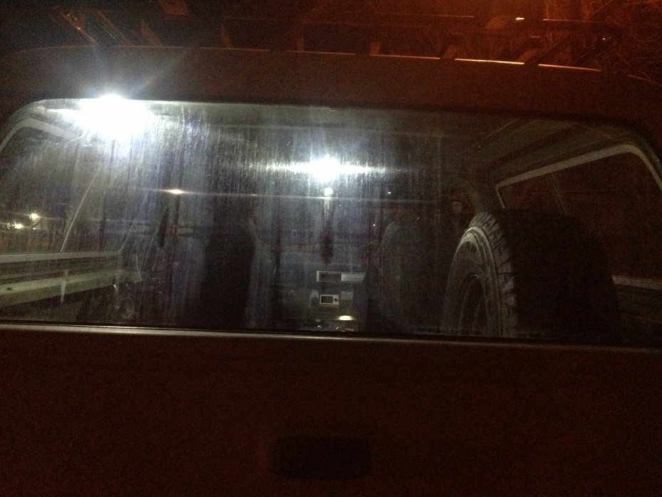

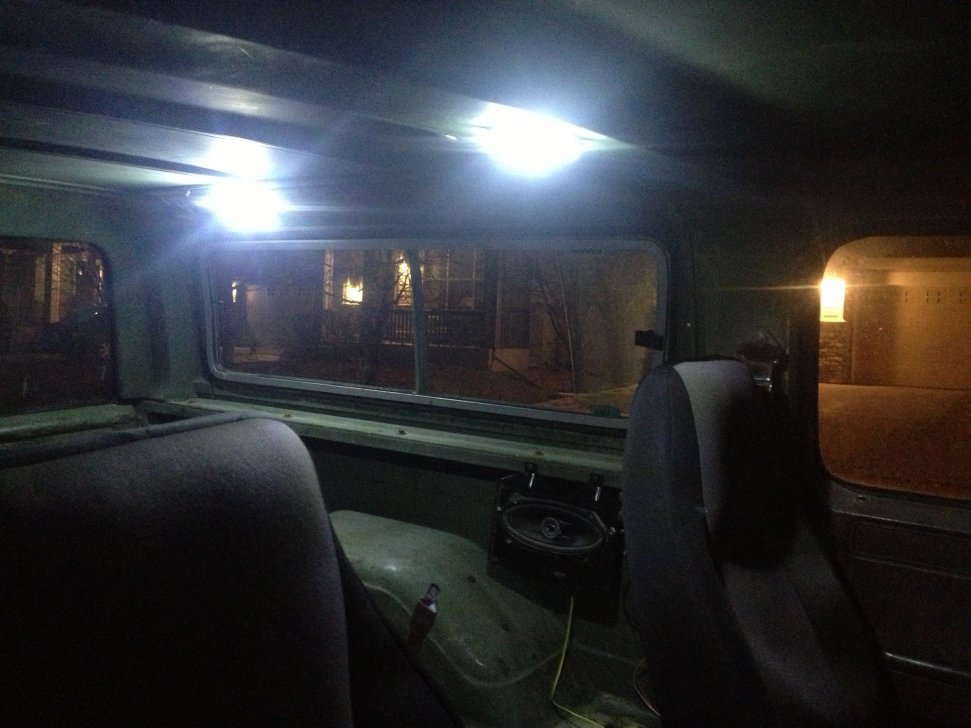

I replaced the interior lights with LEDS too. Suckers are BRIGHT lol

Those interior lights are bright! This is a currently back listed project for me, I was planning on using either red or black light LEDs for the interior lights on the Suburban, maybe running the strip light LEDs down the headboard trim around the sides and cross piece. Definately doing the strip light under the hood for those nights when I find myself having to fiddle with something under there when I would rather be driving down the road.

You can get the same ones on amazon for like 10 or 15 bucks. I just helped my buddies dad put them in his triumph's cluster and they are bright as hell
