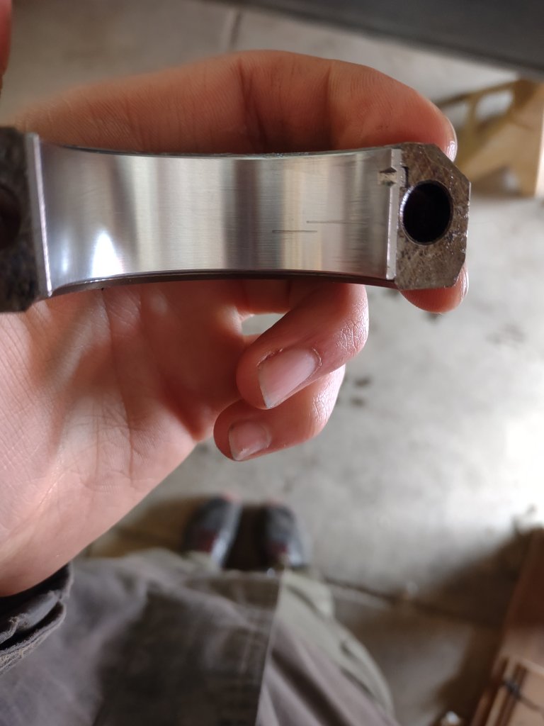

Ok, I don't have an actual gauge yet but I did try plastiguage and I tested twice and got 0.0015. I think that someone said that that isn't enough? Also I included a picture of one of the bearing I had put on. I cleaned the surface and put assembly lube on it but it looks scratched to me. I got the crank at auto zone so they probably warranty it. Do I need to swap out the entire crank?
Also quick question, what is the best way to clean up the pastiguage? it got pretty stuck to one of the bearnings
No picture came through.
0.0015 is way too tight. That's about half the clearance you need. You want to be in the 0.0025" area for main bearing clearance and ~0.0021" for rod bearings. I'd err on the side of looser than tighter. The tighter the clearance the hotter the oil is going to run.

Yeah that makes sense. It is for the rod bearings, I didn't check the main bearings but they seem to move freely like they should. Should I try the same test with some of the original bearings that I got in the kit and check the clearance there?(I got bearings in a rebuild kit(Original size) and some that came with the rebuilt crankshaft (the ones with 0.0015 clearance and they are resized larger I believe))
And sorry here is the picture here

Make sure everything is stupid clean before assembly. Brake cleaner works well to remove the plastigage. It should just wipe right off if you spray it with some. The crank should be stamped with how far over it was turned and the bearings should also be that way.

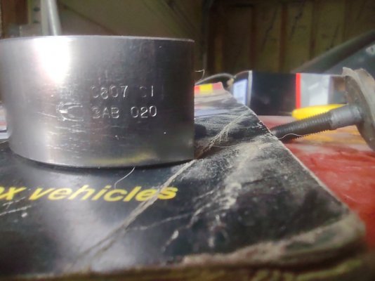

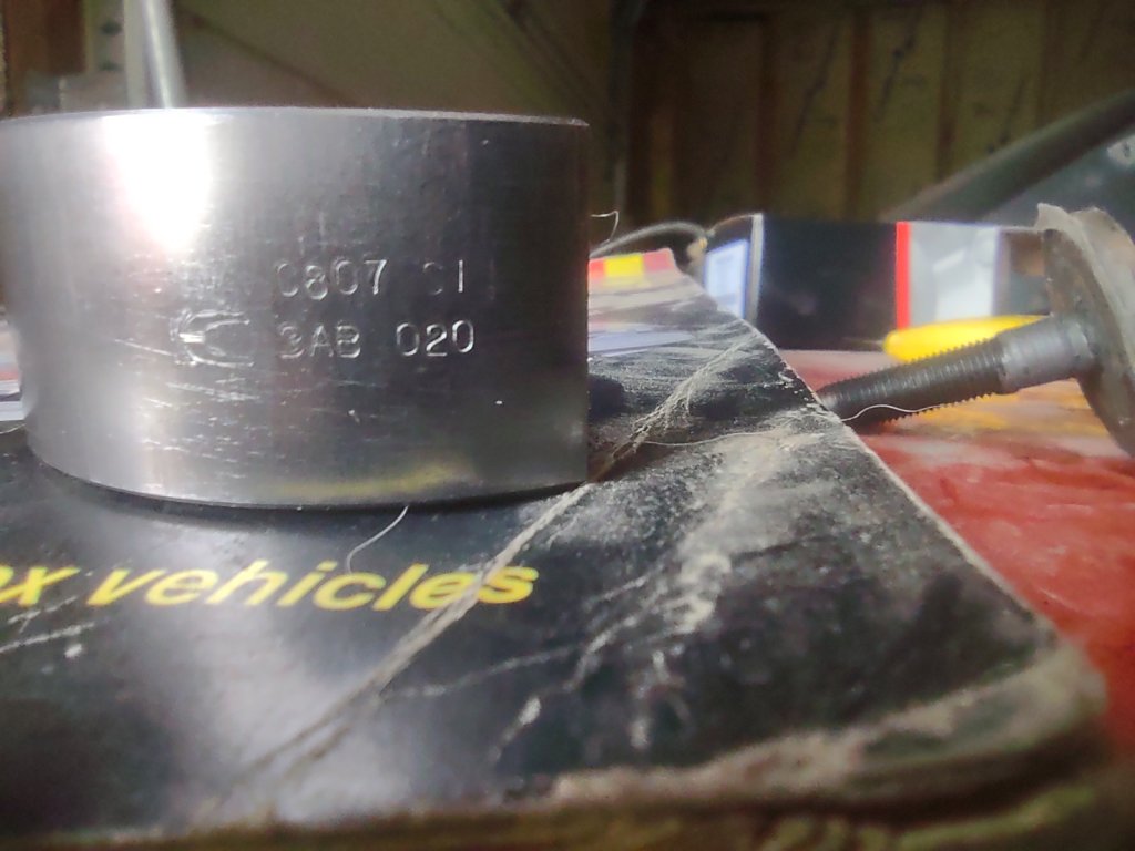

I think .20. I couldn't find on the crank but there are several markings. do any of those look like the mean something?

Those could be .020 under bearings but I thought you said it was a standard crank? Look on the first counter balance weight of the crank to the front of the engine. It will look like this if either main or rods is cut.
This crank had been cut .010 on both the mains and the rods.
