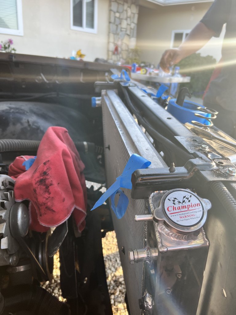

The rad I have is a 3 core - Champion CC161. Maybe someone has already installed one and knows what works?
The originals -might- actually work....just at first glance they dont look like it and everything is still too packed away to easily size it up.
Mines a 3 core too so I ordered these to see if they'll fit better. The leaking one was a 4 core and wider so thats why they don't fit I'm guessing.

I used some obs bracket on mine. Got them from the junk yard for $12 for the both of them.

Yah, those brackets drop the extra inch.
What model/year did you rip them out of?
Never heard of OBS?
Maybe we can find them from LMC for a different year truck?
Toby, do you realize you have the secret sauce brackets that have pissed off a whole bunch of builder's trying to find?
PITA
If you bought the 19" core, find the mounts Toby posted.
It's tough to comprehand somebody has not manufactured a quality set of brackets to solve this issue for the aftermarket welded versions for our trucks.
Every time I search for a new radiator, after 4-5 hours, I end up back at R/A looking at a Spectra single core, (works as a double core).
It is still $125 and fits stock mounts/brackets.

My brain will not justify spending $350 for a radiator and modified brackets, when the welded aftermarket thin metal might only last me 2-3 years tops. It gets -40 every winter. They tend to get pin hole leaks in the tig welded seams from dirt on the welding rods, the guys building the cores cannot control.

This is the HD unit. For 80's trucks, just swapped my old two piece mounts for this full plate, that actually fits the tall rads. The regular spectra rad fits under just fine, but this plate is meant for a 4 core, I used a 3 core bushing set and got it to work just fine, i had to massage the plate a little for some more clamping force to take up the extra room. I also changed it because I wanted a cover over the rad, since my fan shroud is a little modified, and for when I work on the truck.
70's and 80's wont interchange as far as I know. But you just have to bolt in the new plate and that's it. The aftermarket units are a little flimsy.
