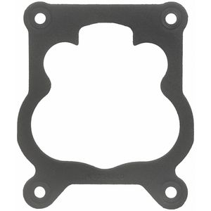

Just get the stock mounting gasket,Look it up in a parts catalog,they aren't all open center as @bucket pictured but they should all be thick and act as an insulator. The difference between an open center and a 4 hole is the open center will act like an open plenum on a car designed for a 4 hole.

Yes, there are 4-hole versions that were used by GM as well. The only reason I posted the open plenum version is because that's what Autozone showed as correct for a '77 when I looked it up.

I was just stating for GP there were both to the OP,you went the extra mile and looked it up by application. Thanks,Merry Christmas
