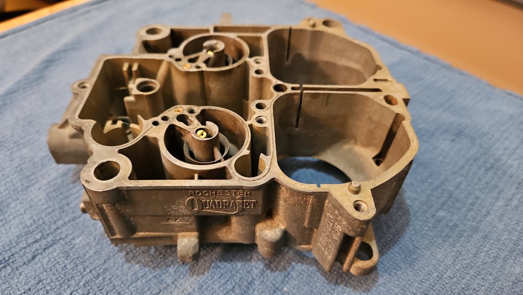

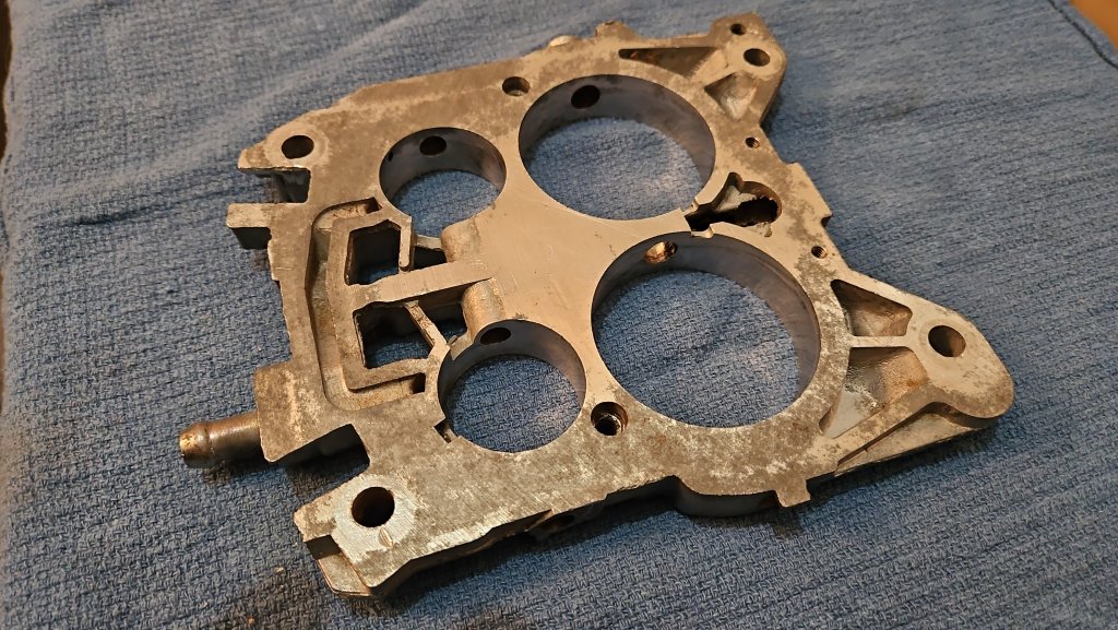

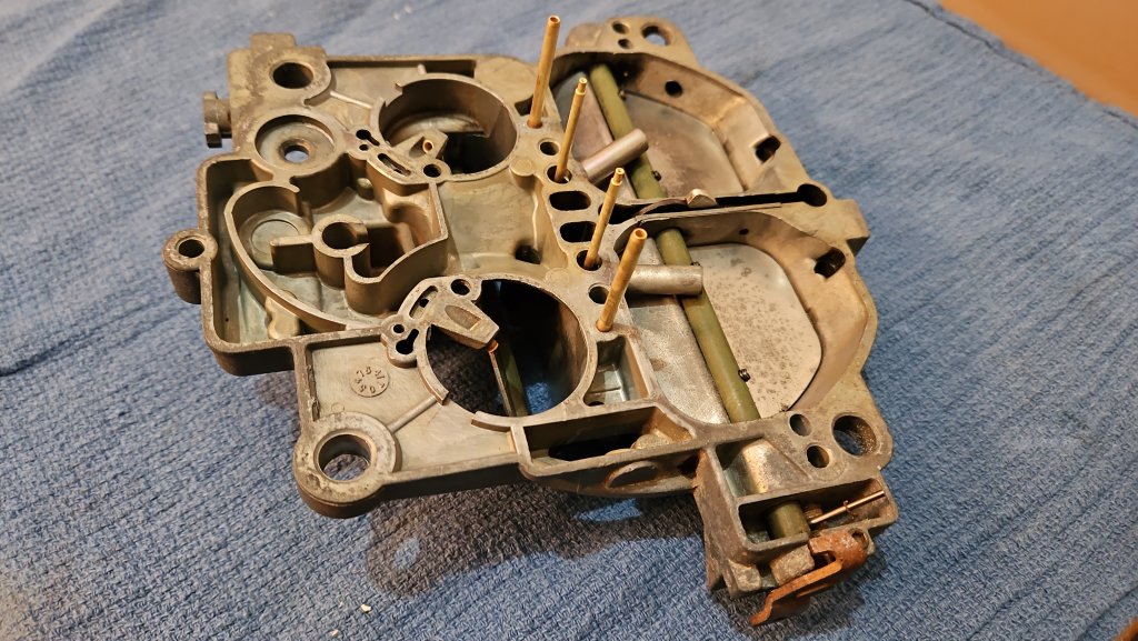

Clean and ready for bushings.

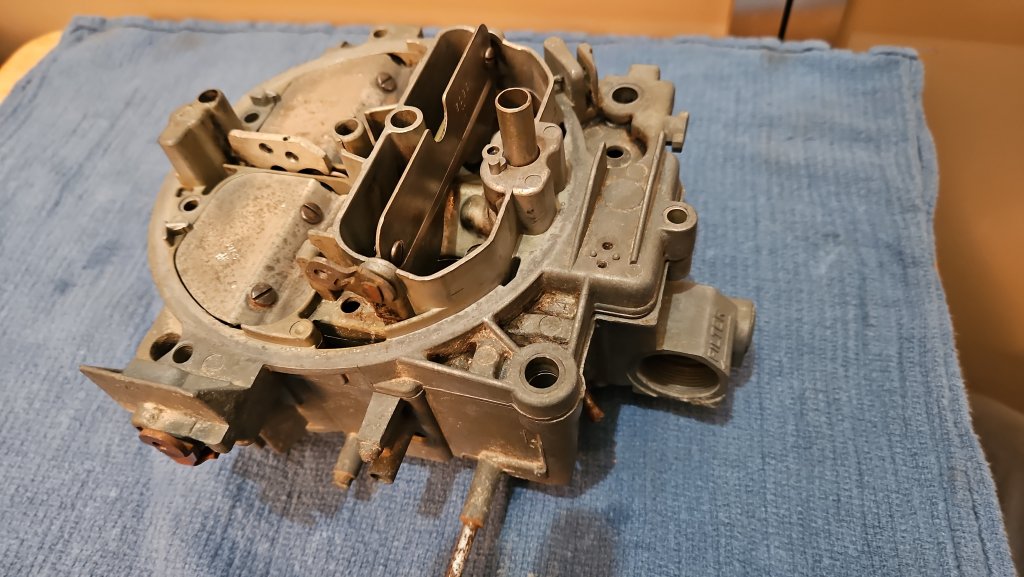

Is that a late 60s carb? Its older style
Looks pretty clean . Mine pretty clean but, I still have black inside my venturi area of the bowl section, and some black on the inside areas of my top plate. Neither of my two have any corrosion at all.
Need to do some cans of carb cleaner spray sessions and tooth brush type plastic brush work.

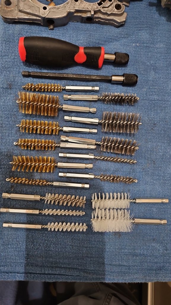

I wonder if a little spray oven cleaner would easily dissolve the black crude in the venturi inside areas without doing any damage?
Why not just get a gal can of the carb cleaner? And while at the parts house, pick up a pack of brushes and hit the head shop and get bristled pipe cleaners.
Let it soak over night.
I think this brush kit was like $20.
I didnt think you can even get that stuff anymore. I live in the boonies and cant get stuff like that anyway
I heard years ago it is all environmentally safe and weak and useless. And the price is outrages
I have plenty of gun/shotgun brass/bronze brushes. But its not a good idea to use metal brushes or stainless steel brushes, rough on the carb casting and bits of wire can break off and get lodged in passages and bleed holes
