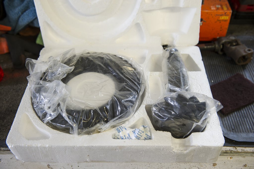

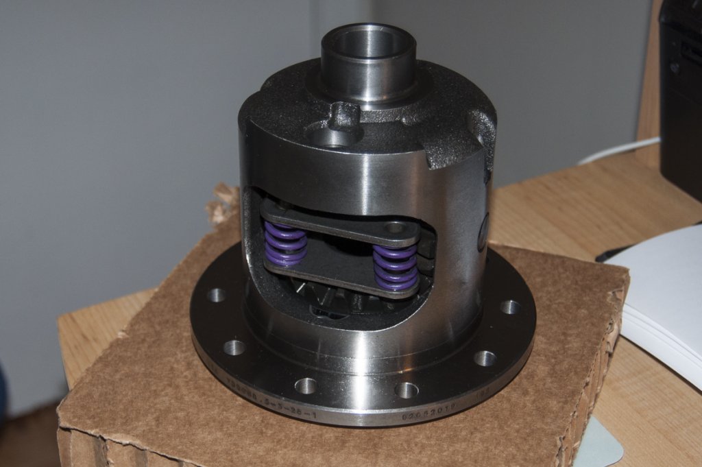

got yukon gear posi unit and brand new Yukon gear 3.42 just love it! 30" tire 4l80e/6L LS set up ;)
