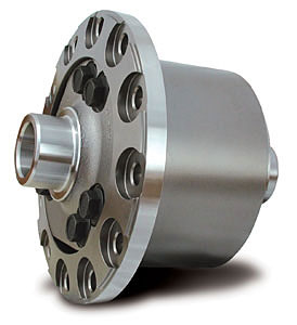

one thing to keep in mind is they are not posi in reverse, I was going to put a tru-trac in my truck but when I was ordering parts from those guys they told me it will not lock up in reverse, so I went with an old school detroit locker as they lock up in forward or reverse.
eaton's website
The Detroit Truetrac is a helical-gear style, limited-slip differential that maximizes wheel traction and enhances driving characteristics. Maintenance-free, it features smooth, automatic operation in forward and reverse. Its versatility makes Detroit Truetrac the ideal traction solution for almost any type of vehicle.
I have one in the front of my truck. Never have had an issue with it- other than one time where my front left tire was off the ground. I could however "power brake" it, (hold the brakes and give it gas) to force the tire not to just spin and then it transfered power over to the other tire.
Your rear axle has a G80- that is a locker. Not the most graceful one ever made but I had one in my ZR2 and my 2003 2500HD. It would lock up when needed.

thats interesting, i never read the eaton website, havent had an issue yet where it didnt work, i was concerned about getting stuck while stratteling snow berms while plowing, ocassionally I need to move a berm thats 4 or 5 feet high and have to strattle it to get the top part moved first, so far I havent gotten stuck yet to prove or disprove if the front will lock up in reverse, the guys at quick performance warned me about the tru trac, it could be BS, but the detroit was a little bit cheaper, the tru trac in the front is soo well behaved you barely notice it.
