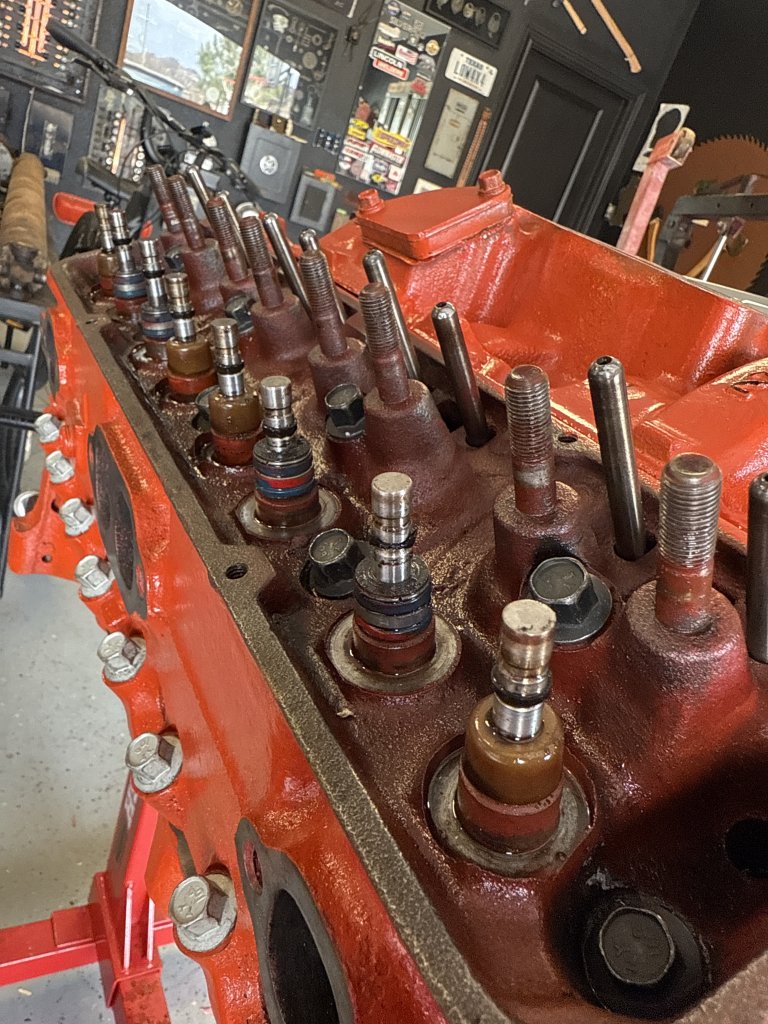

10/4. Any idea why they used different ones on these heads, all they had or is there a reason?

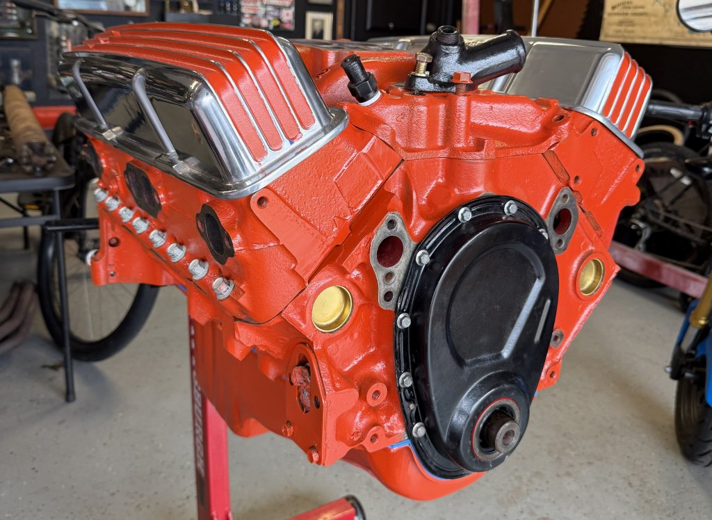

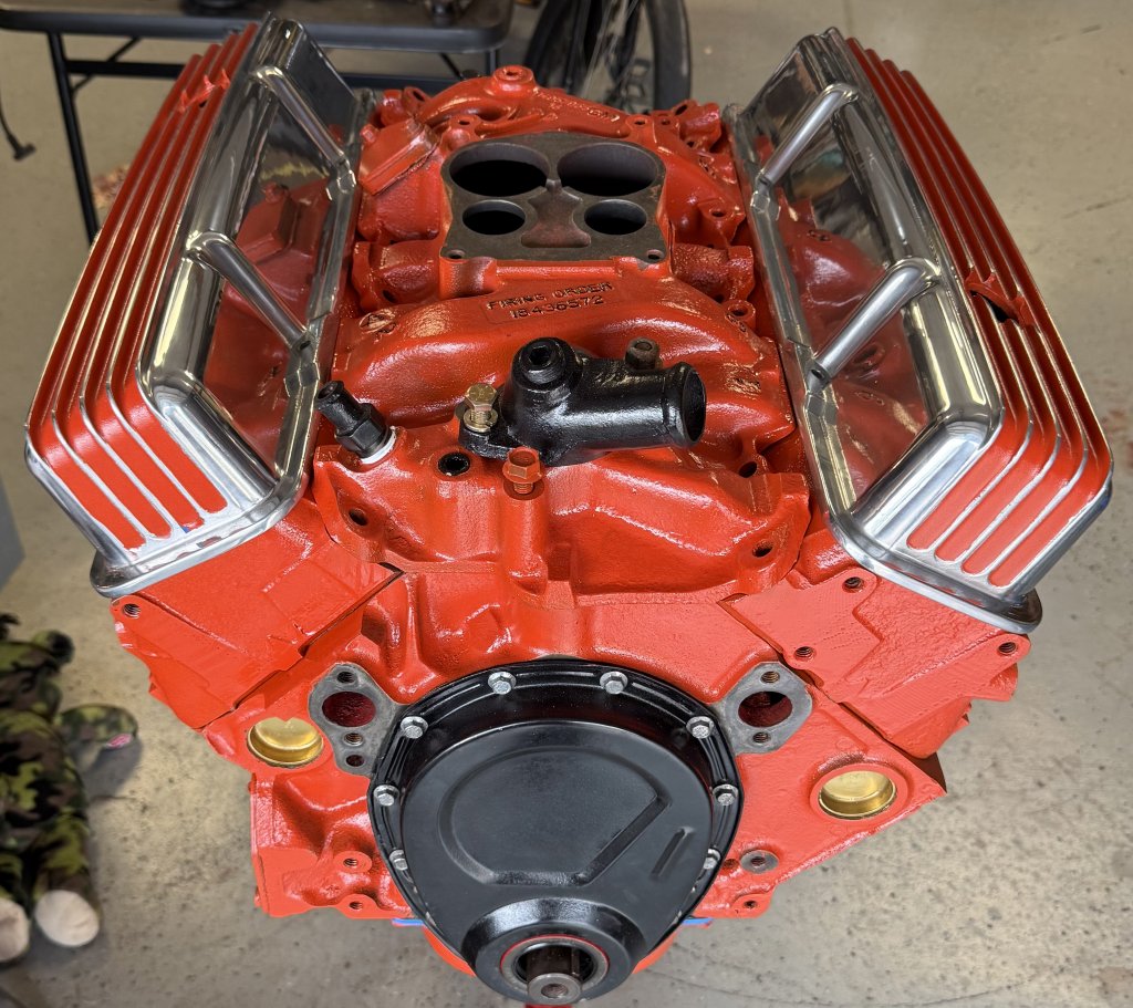

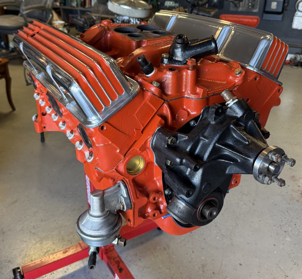

Sneak peak still have to finish springs and install intake
I'm sure they had a reason for it, as the exhausts got umbrella seals and the intakes got positive seals. I just don't know what that reason would be. Perhaps the thought was that the umbrella seals let a little more oil past and would help with guide wear on the exhausts?

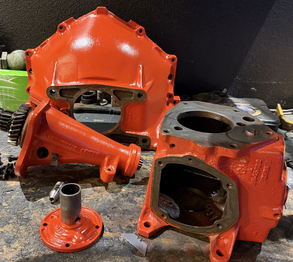

I guess the innards of my trans dont look that bad...just a few small chips on some gears. When I pulled the tailshaft off to change the gasket, needle bearings came out and I lost 2. (There are 24 i believe). So I'll have to order a rebuild kit.
I took the front shaft out to access the needle bearings. Painted everything nice. I put it all back together just to see if I could (still need needle bearings or rollers whatever they are called) but when i go to put the tailshaft back on, it slides in until about a 1/4" inch from fully in. SO not sure whats up with that.
Got the water pump, intake and fuel pump back on.

Assuming you are rebuilding the transmission, it should be better when you're done. With new seals it better not leak anymore...lol...
yes....I hope I can get it back together once I get the needle bearings I need
