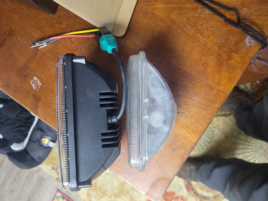

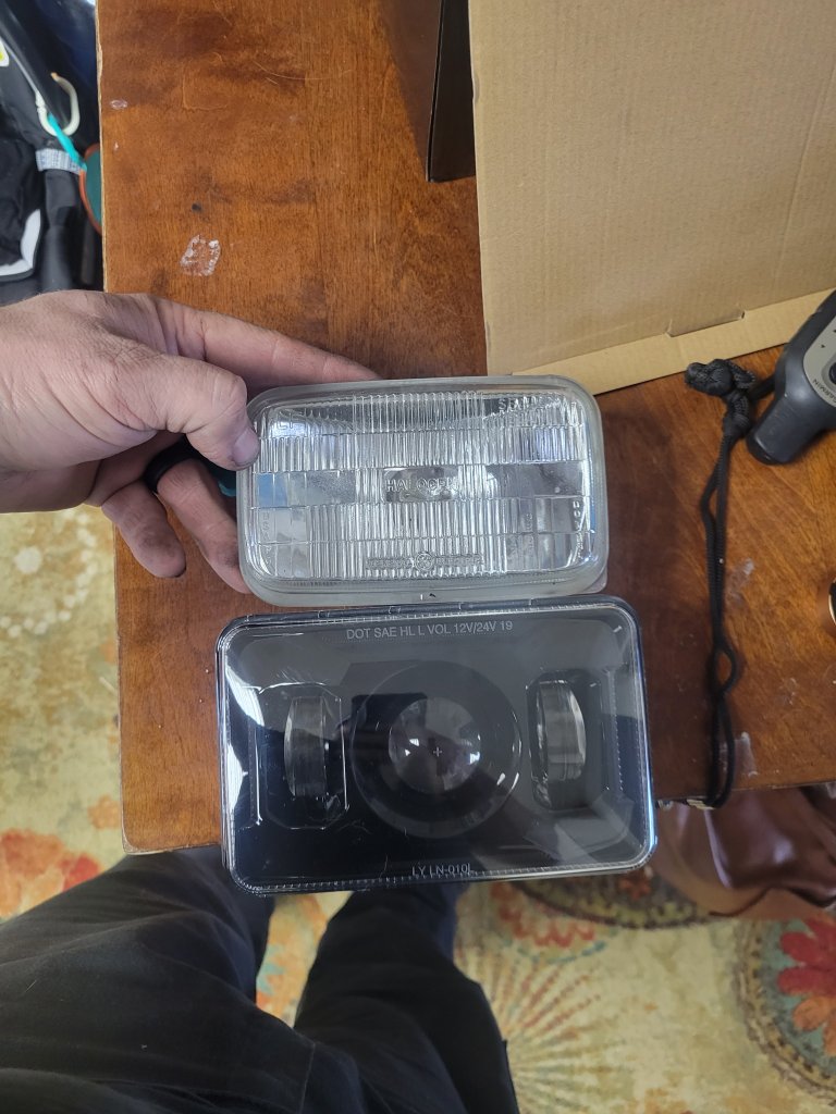

I was looking to upgrade my headlights to LEDs and ordered a set off of Amazon.
Once they arrived it became immediately clear that they won't even come close to fitting in the factory buckets.
What are my options for an LED upgrade?
I have seen the LMC and Hella h4 options, but these aren't what I'm looking for.
Thanks in advance for your help.

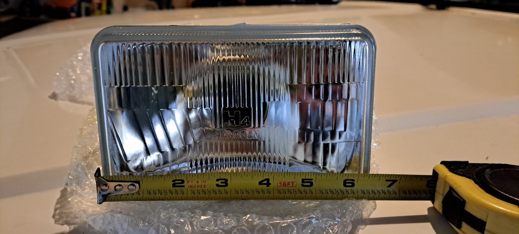

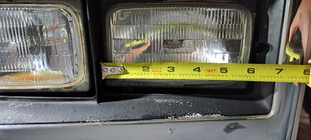

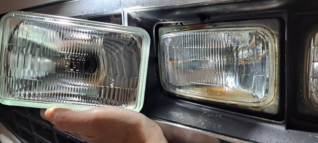

Well, no dice. I ordered these, or at least what I thought was those (https://www.amazon.com/dp/B09SBXXB8M/) , but they are too big for my headlight frame/housing. Short of semi-major surgery, I don't see a simple way to adapt them, so sending them back. Once thing you gotta love about Amazon - no hassle returns!
For others with these oddball size headlights (mine's a '90 Blazer, so possibly adjacent years are similar), these won't work. See pics for size comparisons.
