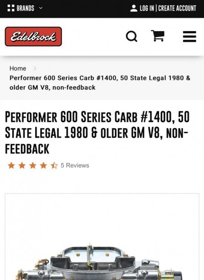

I had my original electric carburetor rebuilt, i was told that was the only option.
Edelbrock says it’s street legal in 50 states- I don’t know when they were officially approved. I had to buy about 10 other parts to make it compatible thought. Just hope it works

His was a feedback carb. That's the problem,and to the best of my knowledge ccc carbs on trucks were CA. only
