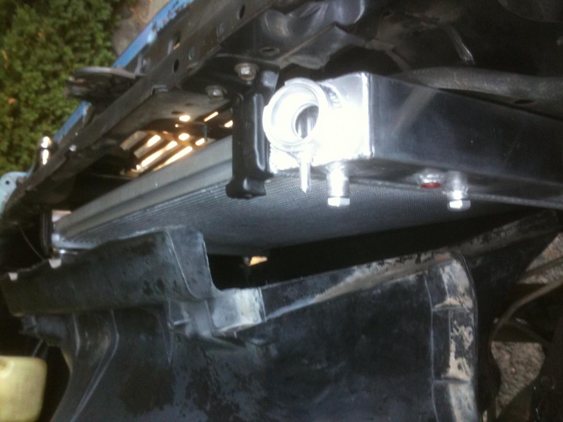

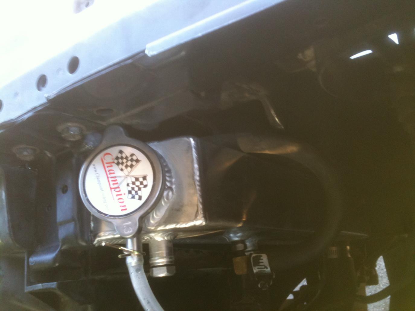

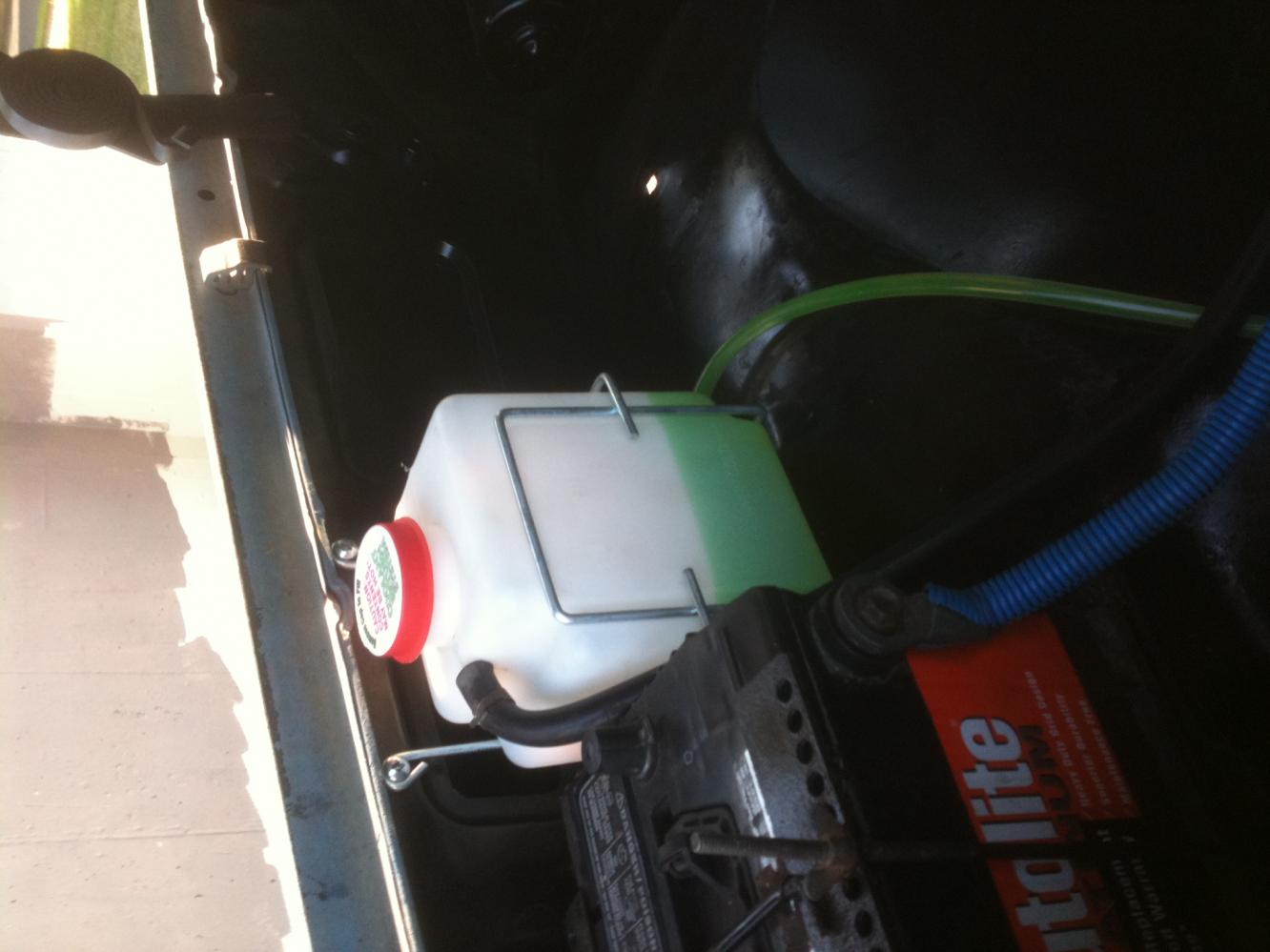

Well, I got everything all buttoned up today. Hottest day in a while so it was great weather for a shakedown run. Runs cool as a clam now. Ended up going with an all aluminum rad from Champion radiator. Big shout out to Champion, I had to send one back that didn't fit and they really went the extra mile to make sure I got the right one quickly. I highly recommend them, ask for Geoff. Great quality radiator for about the same price as the plastic/aluminum ones from the parts stores. Also replaced the fan clutch (it was shot) and found a universal overflow reservoir kit. Here's a couple pix, sorry for the quality but I can't find my camera anywhere.

How was the fitment with the Champion? All the original stuff line up & attach right?? (like the fan shroud, rad mounts, etc.) All the lines go back on pretty easy without any bending required??
TheBigTater
Nov 24, 2010
77
Spokane WA
Yep everything bolted in just like stock. Shroud mounted up fine and the fittings are all in the right place. The rad also has 2 plugs Where you can mount zinc anodes for sacrificial corrosion. Its a great deal for the price and they're great people to do business with. Even though I had to wait for shipping I'm glad I went with this one.

A word of caution on the overflow tank, I have the same one. You want to keep those hoses from pulling on and putting pressure on the tank fittings, mine did and the nipple cracked on the bottom. I JB Welded it up and is fine for now, but made sure the hoses were not taught. My even be a good idea to fasten the hoses to something to keep the pressur off the fittings.

It was like 175 with shipping. If you have a Fedex account they'll happily bill your account and save you some money also.
I know what you mean about the tubes for that overflow tank 89S. I have some hose clips I'm going to screw to the inner fender so I can control the slack in the hose. Thankfully I had more than enough hose so it isn't stretched at all. I just want to get it a little better secured before winter when it gets cold and brittle.
