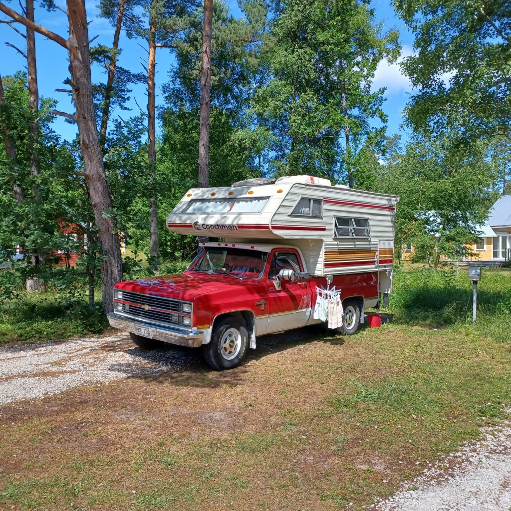

Happy Monday. A rebuilt converter was what needed. My TCC are there again. So nice, take of with the camper tomorrow!
