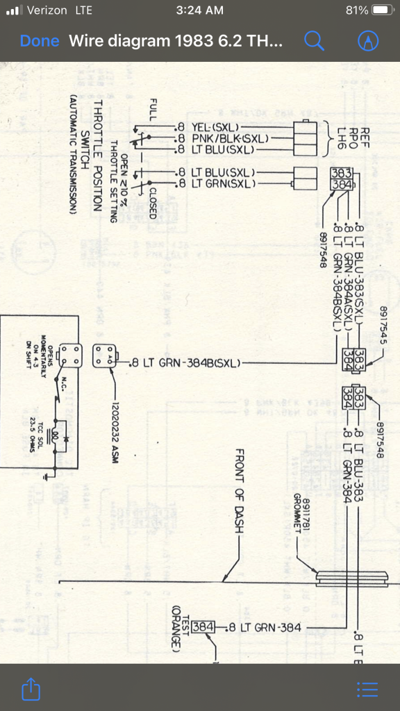

Really a great forum this. So many helpful guys out there-. Attached is a wire diagram that shows how the OD in my trans is powered. I'm wondering if someone can explain what happens inside the trans with the components shown in the diagram. A Normally closed switch and a relay by-passed one way with a diod?? Anyone understand the function?

Looks to me like the throttle switch allows the converter clutch to engage with more than 10% throttle, and disengage at WOT. There is a pressure switch in 4th gear, however I don’t understand exactly how it’s suppose to function. It says it showed open momentarily on a 4-3 downshift, I’m guessing that’s a misprint I bet it’s supposed to be a normally open switch that closes when the trans shifts to 4th gear.
You can monitor the TCC on the orange test connector, wherever that is.

My words guys. The 6.2 does not use ANY VACUUM OF ANY SORTS for the 700r4 transmission or it’s converter. The vacuum converter switch was only for the gas jobs. The 6.2’s have an electric throttle position switch on the injection pump that will lock and unlock the converter depending on throttle position.
I believe the momentary 4-3 unlocks the converter during the downshift, the. It can lock again once in 3rd.

OD o lock up? First, please tell one that dont eaal y can sort this out. Look att the attached diagram. OD or lock-up?
Then; vacuum is for sure not included. The attached wire diagram is how my trans is wired. I have installed a control lamp that lights up once the green wire down to the trans is hot. And it does, so I know its not any fault outside the transmission. It can be that there is a fault in the connector on the trans. I have to lower the oil pan to check that. If not its definitely inside the trans.

Now I learned some basics. My problem is the lock up/TCC. (Because overdrive=4th gear not any 5th gear). So my remaining question is:
What prevents the solenoid to be engaged on every gear? As I read the attached wire diagram (previous post) it looks to me the solenoid has power supply all the time, no matter which gear the trans is running on. The only interruption is when throttle is below 10% and when down shifting from 4 to 3. Anyone that can explain?

It appears the 2wd diesel locked up every gear.
The throttle switch unlocks below 10% throttle (think stop light, take off, coasting)
Then briefly unlocks during the 4-3 downshift.
Mine used to have this but when i converted to gas, i rewired so that it would basically be locked anytime it was in 4th gear.
Also, not shown on the diagram, so maybe a later model thing, I seem to remember a temperature switch in the harness that would prevent lockup until the trans warmed up.
