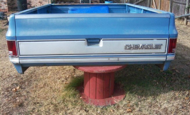

Here's what everyone with a lift needs to work on their truck. Find you an old wire or cable spool. Plenty of platform and it won't slip and get away from you. I've got 2 and not giving them up for nothing. They come in handy for many things.

I've never seen that before. I use them for picnic tables and work platforms. To get them find a electric supply firm that works with contractors. That's where I get the ones I use. I get them for free but occasionally they might charge for them. The last time I went was few years ago and they gave me all sizes and as many I could fit in the back of the pickup. Be warned that they don't take to being wet for very long, a couple of years max. They are normally just cheap pine wood. If you can get one made of hardwood, wow that would be great. I have only seen a few and those generally bring a premium, if they get rid of them at all. I sprayed one I gave my BIL with Thompsons water seal, but he sold his place a year after that so I can't vouch for whether it did any good or not for longevity.

Most places will charge you a core for those spools. upwards of $100. So if you get one for free, you have scored!

I have a buddy that works for the electric co-op here that just brought me some the other day for free. They get all they want. The co-op doesn't have anything to do with them once they are empty so they let their employees take all they want. If anybody is ever down this way and wants some just let me know, Im starting to get a nice collection. I make patio tables and stuff out of them, but they are great to stand on if you have a lifted truck and cant reach the motor.
