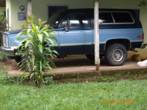

Besides stuff like creek beds or eroded landforms, is there any strenuous terrain in Nebraska or neighboring areas? I imagine that a well tuned carb would do okay in your geographic situation. I couldn't say the same for aggressive mountain terrains, dunes, or localized places that have a high variance in elevation. Then again, my dad exported his '86 GMC Jimmy to Panama about 22 years ago so he could climb mountain rock paths and roads to get up into the highlands to see his property investments. Some of that stuff is steep, dangerous, and locally inaccessible unless you have access to a horse. Not necessarily rough just highly inclined. That old truck only had a 305 Q-Jet with manual locking hubs and no lift. No rejetting, same old factory tune, and it did well. That was a great truck to have waiting for you when you went on vacation. The first thing I ever drove and the image that made me want to get into square bodies, a Jimmy more specifically. Anyways, I digress.
