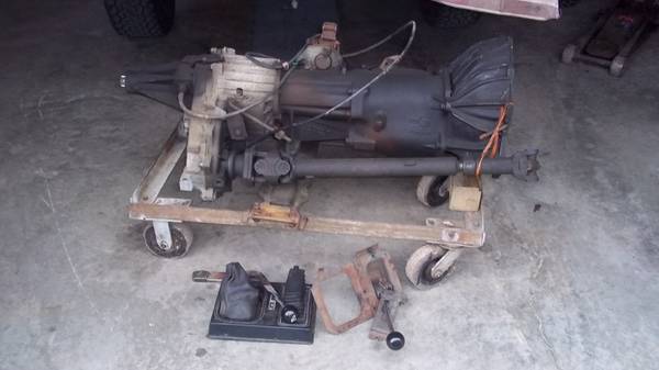

And look as this pic @tsailer2 . You see what I'm seeing here? And this is a 4x4 unit OBVIOUSLY. Also look at the stick. The stick is the squared one, not the round one. Do you see that bracket how the round portion of the shift is recessed and going thru the bracket. So now I wonder, was this factory, or did someone do what you're having to do. That shifter is clearly the style of the one that you say came off of a 2wd and won't work for you. Must be an OEM bracket out there for that style shifter. You know these transmissions ran from 81-87. They could just be year model differences. All you might need is to find the 4x4 bracket for that style shifter. Mine is like your 4x4 shifter, without the recess and with a round stick instead of square.
This guy was selling this whole compete set up for $400.

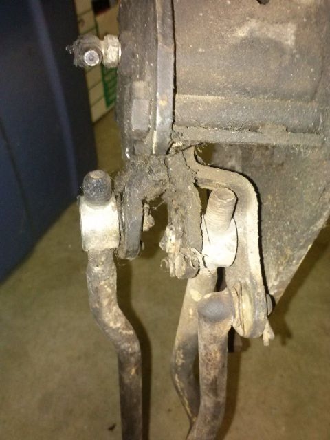

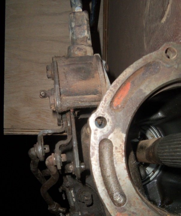

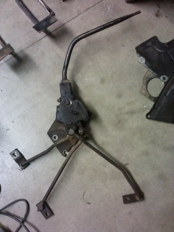

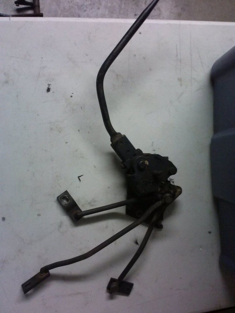

Ok, so now that you read all that. I do see why the Dodge shifter won't work. Not going to say we can't rob parts for the Dodge shifter though. I got that one eBay seller to send me pics from the behind of the shifter to see the offsets. Comaping them to our offsets. There's where the problem is. Notice ours have the offset otherwise they'd hit the transmission housing.
First pic is our 4x4 shifters from behind.
Second pic is the Dodge A883 Pick up Shifter.
Other than the damn finger offsets, they are the same shifter though. Down to the grease zerk. Which does mean, the Dodge rebuild kit will work for ours.

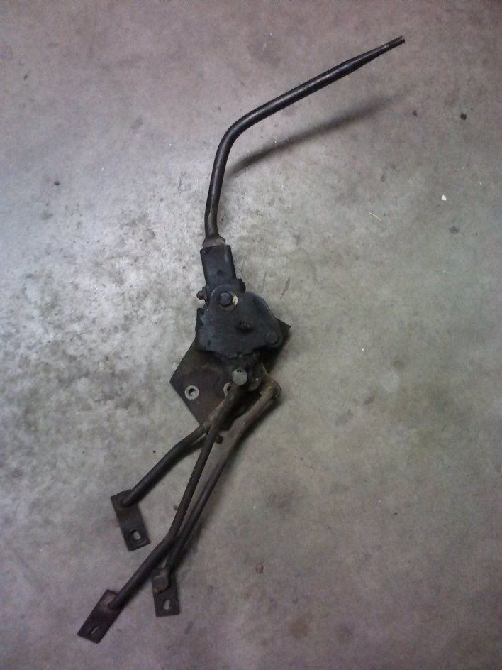

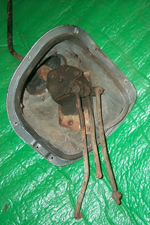

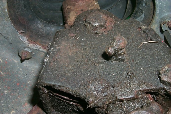

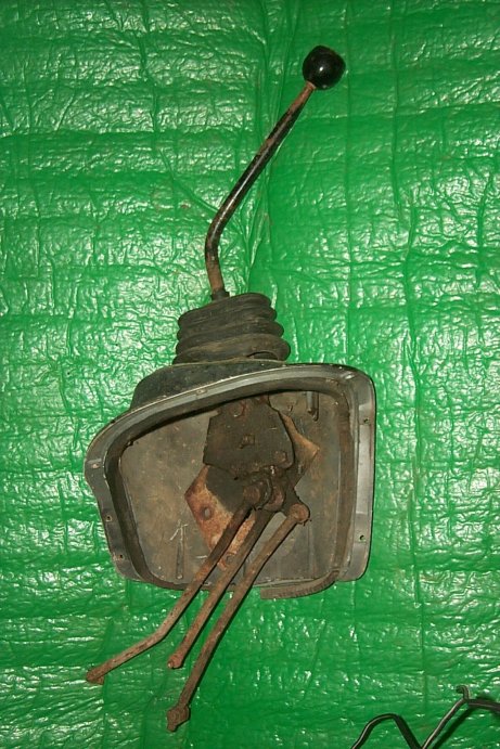

I've been emailing with a Hurst rep. He responded to me today. He says the Hurst Competition Plus rebuild kit WILL Rebuild my shifter and your original shifter. He's talking about 2 different model shifters were available. 1 will work, and 1 there are no parts for and not 1 single part of it is interchangeable. He says the one that will work, is the one that has the housing that looks like the Hurst Comp Plus shifter with the grease zerk on it. So the one we want, is the one I have, and the one you had originally. The one we don't want, is the 2wd shifter you have. Also the same shifter on this 4x4 set up. Obviously the shifter you don't want is the one with the square shift stick and that round section that has to go through the bracket. There is no zerk on the unit either so I'm sure that's the one he talking about that they can't offer any support on. I also notice the one that CAN'T be rebuilt with the Hurst Comp Plus kit, also has 3 bolt through the shifter to the mounting plate. The shifter than can be rebuilt, is the one that only has 2 bolts to the mounting plate.
This is the NON Rebuildable shifter that there are no parts for.
attachment.php
attachment.php
attachment.php
This is the one that IS rebuildable with the Hurst Comp Plus rebuild kit for a little over $100.
attachment.php
