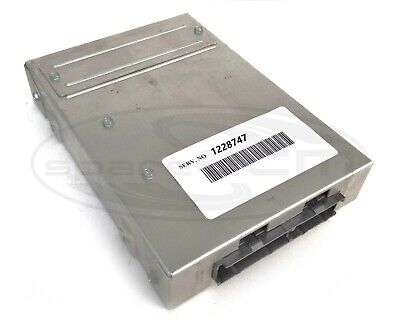

Fuel pump relay has been replaced. I swapped it as an outside chance it could be causing an excess electrical draw/voltage sag. I'm not losing the fuel pump itself (I even jumpered the oil pressure switch to force an always-on state and still had it shut down).
When it went into the second failure mode of spitting back through the air cleaner at any amount of throttle, it again cleared itself after a power cycle.
I was thinking to ONLY power cycle the fuel pump instead of cycling the key. Just trying to narrow it down. link to new ECM above. that's the same vendor I got my spare ECM from when I thought maybe my ECM was bad.

you will just have to swap your PROM to the new ECM.
I wonder if we just discovered the problem: That link is for an 1228747 unit, my truck seems to have (upon visual inspection) a 1227747 unit. Did someone swap in the wrong ECU??? Is there any way to determine which ECU I am supposed to have?
There might be a sticker under the dash by the ECM that has the number in case somebody installed the wrong one? But I'd think you'd have larger drivability issues with the wrong computer.
Could also be that they swapped ECM with the new body style and those got a different computer. Might have to research to see which is correct

Well I just got my claims-to-be-remanufactured ECM about 3 hours ago, I'm certainly going to try this first and see if it solves my issues because it would be the most seamless method. If not then we go deeper down the rabbit hole (and deeper in the hole money-wise as well).

I pulled the old ECU last night - didn't see any obvious signs of problems in terms of connectors or odd burned-electronic scents. Swapping the ROM chips over was a bit tense because those can't be replaced if damaged, but I think they transplanted safely. I may pop the new unit in tonight or wait until tomorrow evening when its not sun-surface temperatures outside. Its a 50-50 dice roll on whether this will really the problem or not but the only way to know is to try it and see.
