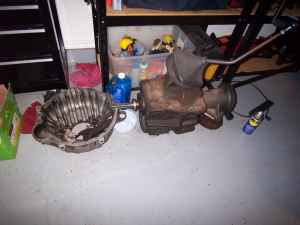

Transmission is out and to my surprise the shafts are totally different. Son of a bitch. The transmission I pulled out has an output shaft about a foot long and the one I have to replace it has a output shaft about 3 inches long. At a loss now.
I pulled the cover off of the bad transmission and everything looked suprisingly good, when I turn the shaft by hand you can hear it making bad noises. Anyone know of adapters that could help me in this?

This is a 4x4 truck right? That long shaft or cone setup looking thing is your Transfer Case adapter. So did you possibly buy a 2WD SM465 instead of a 4x4 SM465? I am not even sure myself. But someone who knows may chime in. I wonder if the Tcase adapter has its own shaft and will it work simpley by swapping the trans case adapter from one trans to the other.
47,132
9,331
This is a very cruddy pic, but its the one the guy had on CL, and I bought this one for $50. Notice the long cone on the back of it. That is just the Tcase adapter. A 2wd unit would probably just have a yoke on the back of it.

The transmission I bought was definetly a 4x4 unit since I watched him uncouple it from a np205 transfer case. The main shafts are way different, The good one I bought had a little coupler that just slipped onto the shaft between the transfer case and transmission, the one I need goes directly into the transfer case.
I called the dude and explained why I cant use it and he said he has buddy with a sm465 He just pulled out of his 85 with a super long shaft like mine, I will go pick it up around noon tomarrow for 100 bucks.
he said he would sell me the np205 that goes with it for 150 and I could find the drive line in his backyard which sounds tempting... I would rather just find a direct replacement for my trans at this point and get it put back together instead of chasing down drive lines and U-joints and ********.
