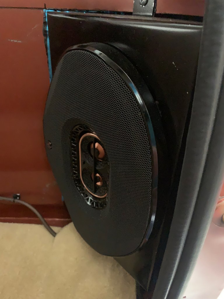

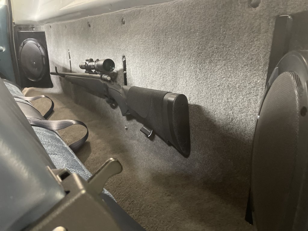

I have these with some Pioneer 3-way 6x9s in them:
With these behind them to aid in bass/mid range response:

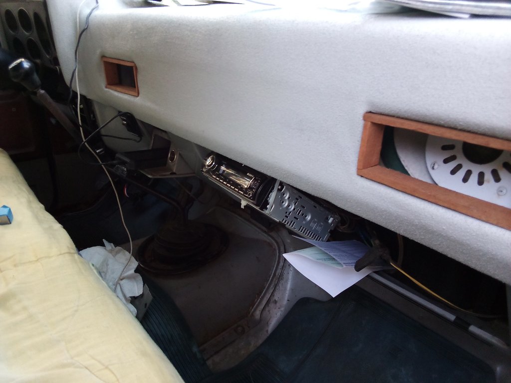

And these in the dash. The dashpad fit down fine on them, though it does bulge up just slightly. You do have to mount them on the bottom side of the bracket, putting them on top of the bracket makes it bulge too much
