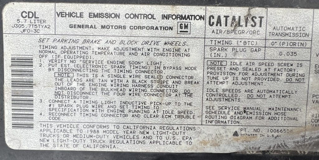

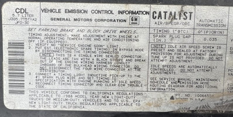

Hey everyone. I just swapped a new ATK TBI 350 into my 88 suburban. Everything went well. Good oil pressure. Temps are good. No leaks. No smoke The engine runs and drives decent. Cruising is great. The only problems are hard starting (lots of racket almost like it’s missing as it tried to start) and sometimes it dies at idle or when shifting into D or R.
I think my issue is timing and TBI idle settings related. I stabbed the distributor pretty close. It initially hunted a lot for idle. I clocked a little advance into the dizzy by hand and it helped some. I couldn’t get a good reading with the timing light.
I’ve read lots of posts regarding the need to disconnect a brown or tan wire before setting timing. However, my truck’s wiring doesn’t appear to match any of the other posts/photos/videos I have found.
I would really appreciate a “101” lesson on how to do a proper TBI/timing initial setup on this new engine. Feel free to talk to me like I know nothing about the OEM TBI on my truck—because that isn’t far from the truth.
Thanks.

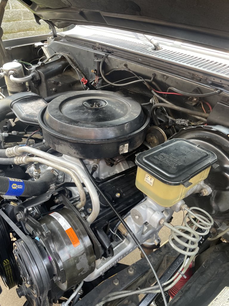

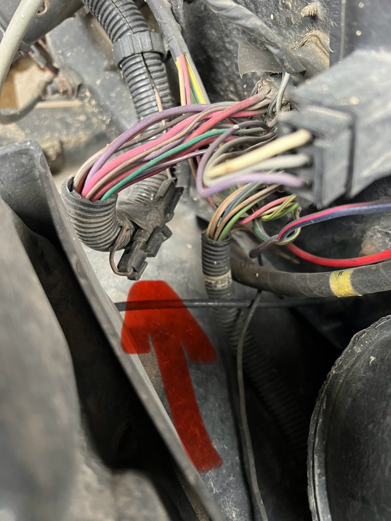

This is on my ‘88 K5 with a 350. Everything is 100% stock and unmodified. The brown wire is near the bulkhead connector. Hope this helps.

Mine wire was right inside the wire loom oddly enough. I assuming cause it only had 85 km when I got it it was never timed since it left the factory

Y’all nailed it. Thanks. Running MUCH better now.
