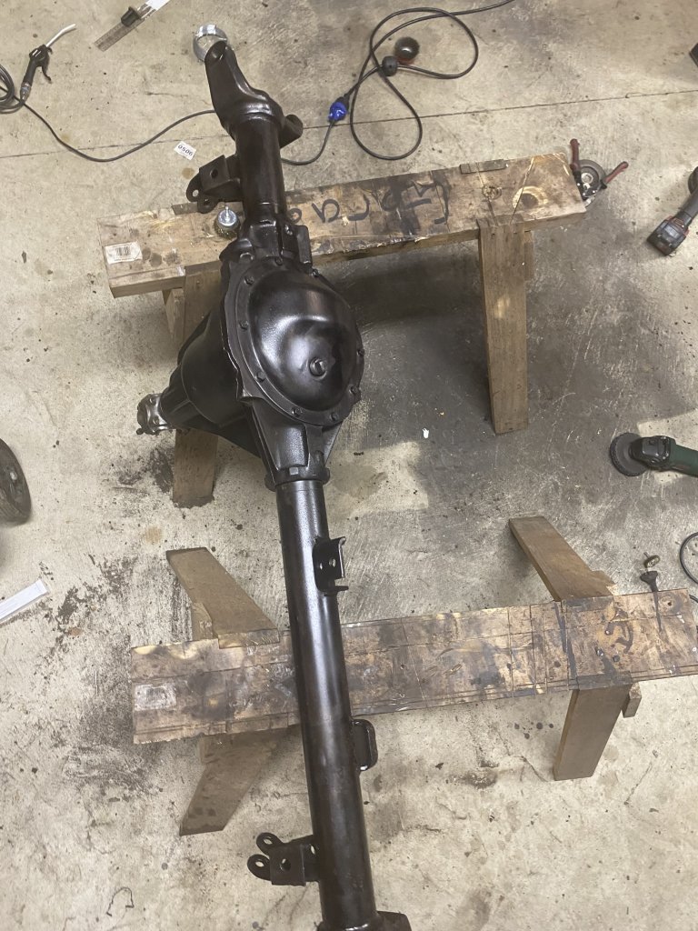

I have an 83’ it’s also got a corporate 10/8 lug in it.
From what I’ve read they tend to bend if you bounce them and 37s break them. I’m running 37s on mine so I’ll see how they go.
In this side of the world (Nz/Australia) a few vehicles have soft axel housings and we add gusting to them to strengthen them. I’ll be doing this to mine.
