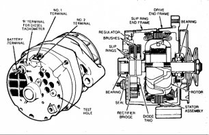

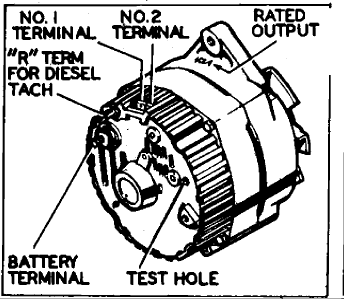

I believe that the impulse for the tach on the 80's diesels was taken from the alternator. It's easy if you have the correct alternator.
From some other place:
hi,here is the post location ,I included both styles of alt either one ,should have the R terminal as for a tach wire.....guy..
in that case there is no hook up for a tach on your alternator ,in that case you may have to either get an alt with the tach post on it or if there is an alt starter rebuilder in your area have them install one on it ,which would be cheaper to do than buying one .or if a junk yard has one ...guy..
