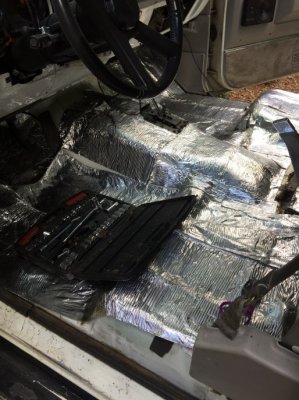

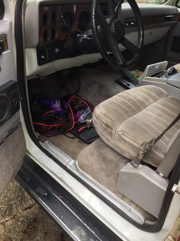

Started putting In some insulation cleaned the carpet more too, planning on putting the original back in for now and buying new down the road. might still put some Jute padding in on top of the insulation

Looks good. What brand insulation are you using?
Thanks,
The frost king cheapo insulation from Lowes..its foam backed so no tar and I still have the vinyl that was between the jute padding and carpet which will go back on top of the tranny tunnel then the old carpet which I cleaned as much as I could....I literally hung it up and beat it with a bat and I could not believe the dirt that came out, it made the white pavement turn black with the stuff that came out then vacuum and simple green. didn't et all the stains out but at least it is saturated with sand and dirt now

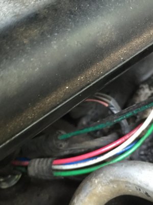

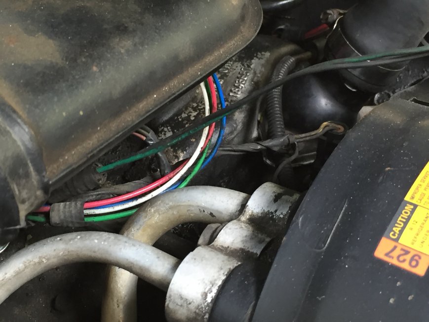

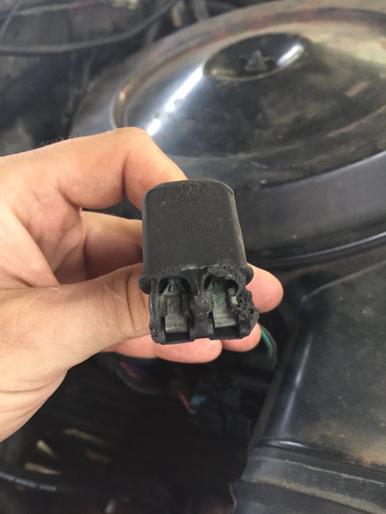

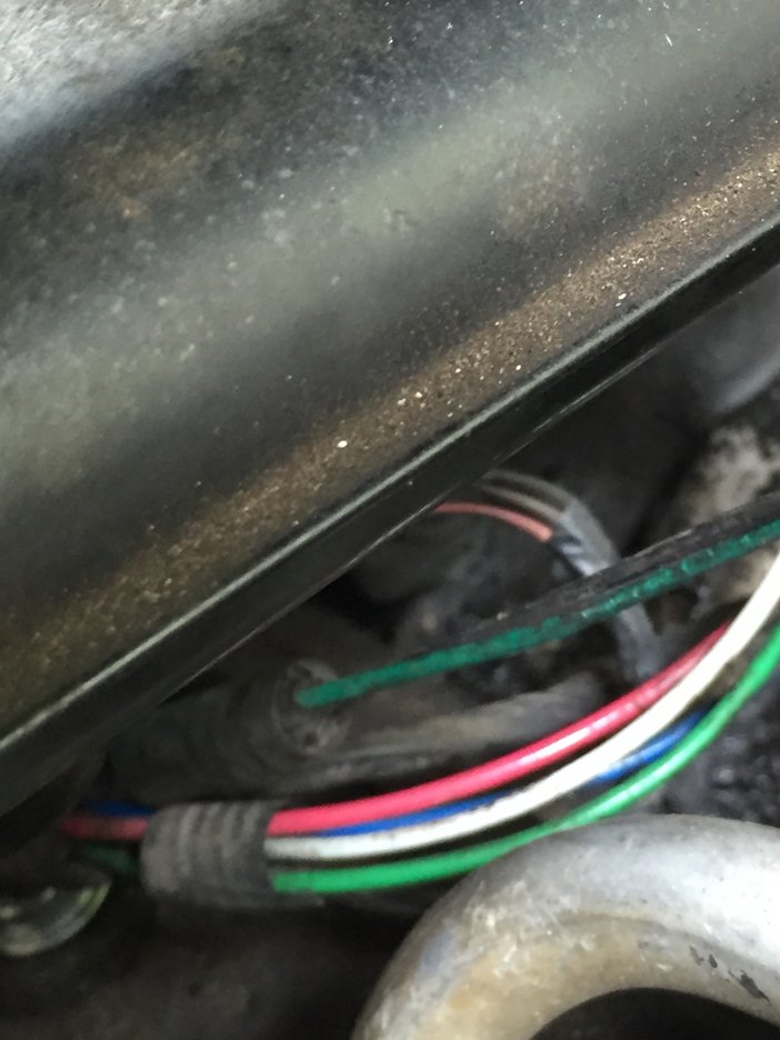

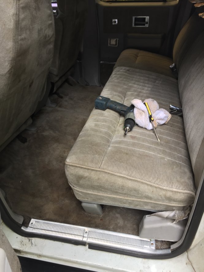

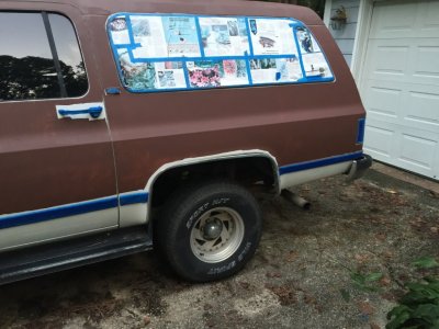

Okay, was able to get some more primer done this weekend and all the carpet seat and interior trim back in for the time being, I have just cleaned the carpet for now, still has stains but the stench and dirt are out of it finally, and with the insulation it is very quiet so far. Once the headliner goes back in it should be alright as far as being a functional driver. I also took some pics of that connection that melted and where it is coming out of the harness by the PCV valve maybe someone know what it goes to.
but yeah I know it looks ugly right now, but hey its primer and frankly its a million times better than it was.

and here is that connection if anyone knows what its to and if it really matters. everything seems okay without it so far.

that kinda looks like the AC clutch connector...
is it a 90* angle? turn it on its side?

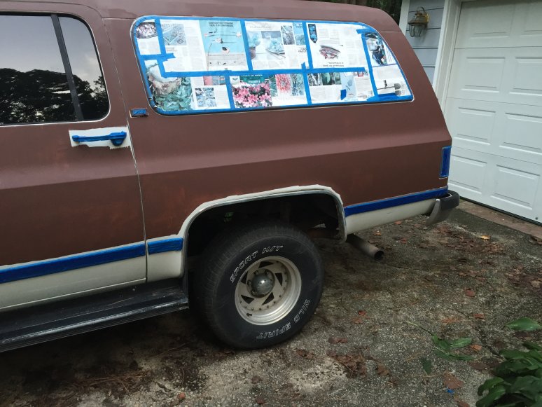

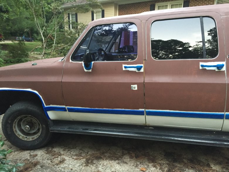

yes the connection is a 90 degree turn and has that green wire coming out...that would explain why it doesn't cool down. hah I guess ill see if I can still get it to work or if that's it. Also did some more taping last night...soo freaking humid down here tape hates it plus prep work sucks anyways. oh well hopefully ill be painting soon. then it will be purely mechanics and looking for axles. oh and those side steps and bumpers are a pain the ass to get off I may just cover them
