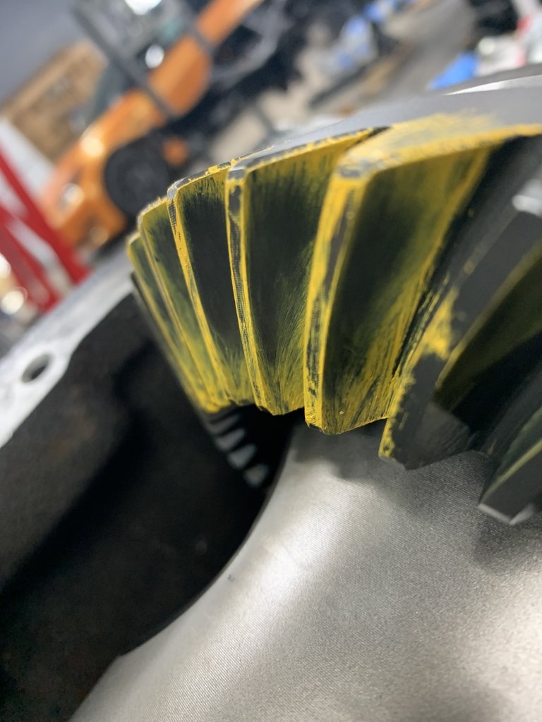

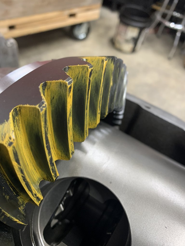

Looking for some advice. I finished up on my front. Now I’m on to my rear set of gears. Please let me know your thoughts on the gear pattern. It’s a GM 10-bolt 8.5” with backlash at 8. Thanks

I’d run it…
Looks good to me

ius the yellow being wiped away on the "top" of the gear meshing interface too much or did you not directly wipe it on the top oonly on the faces? I guess I dont know how close that stuff is when its meshed
Just sloppy when I applied. Never meant for it to be on there

Remember, this is the drive side:
The drive side, most important, coast side, not so much. The pinion could be a little deeper, because the pattern runs off the edge.
Are these used gears? The pattern is good, run it!
These are a new set of gears and carrier
