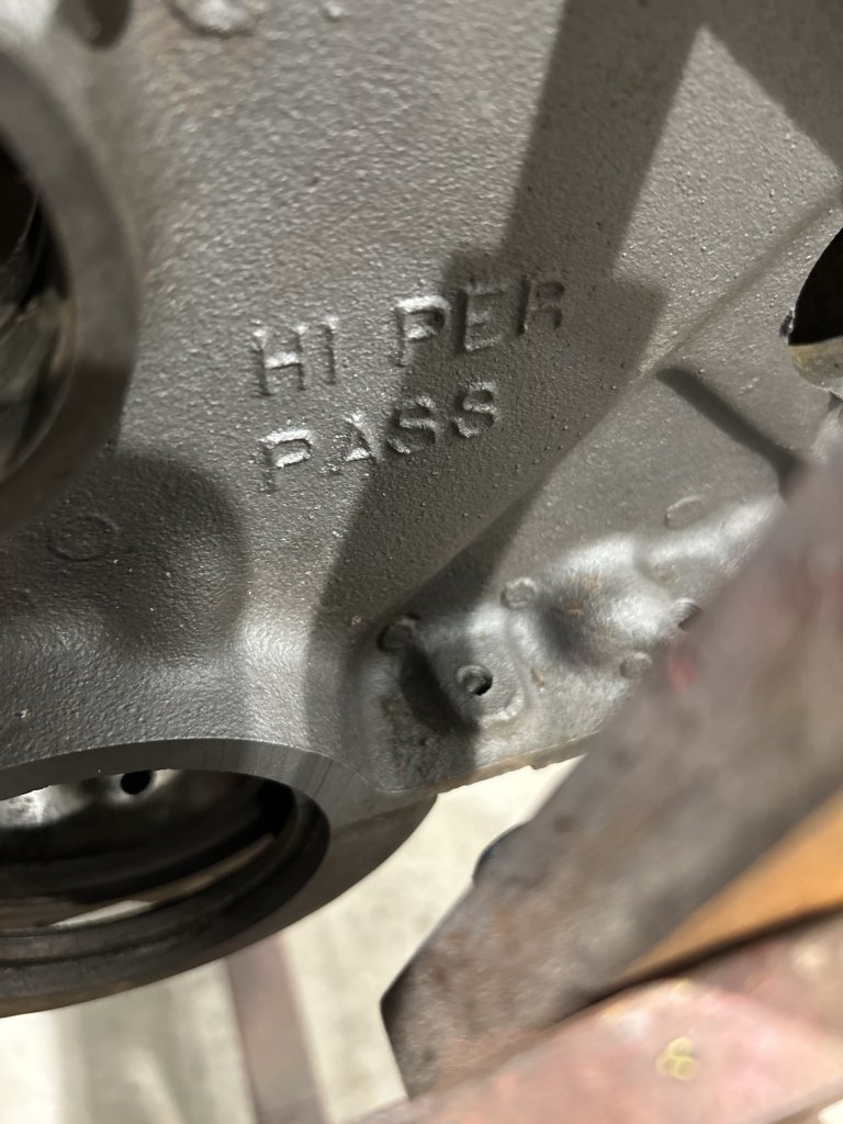

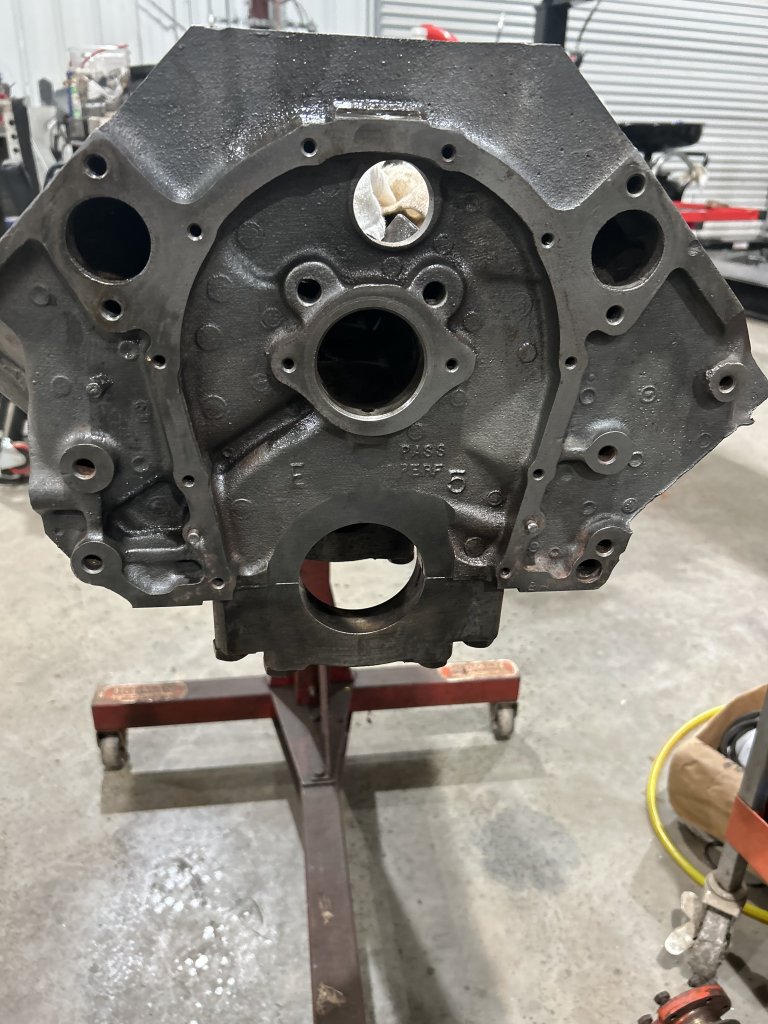

finally got my 454 engine . Long time in the works. But hasn't been a rush . This is going in a 69 chevelle , it's a standard bore 4bolt , 781 heads . Looking to get insight on other people's engine builds , was considering a 496 stroker kit , however the thought of a 60 over punch rite off doesn't set well . Was wondering how the roller cam set up has been for others here aluminum heads etc . I just want decent power and sound and reliability. Later in life I can go with a 496 build . Any insights on the topic would be much appreciated. Thanks

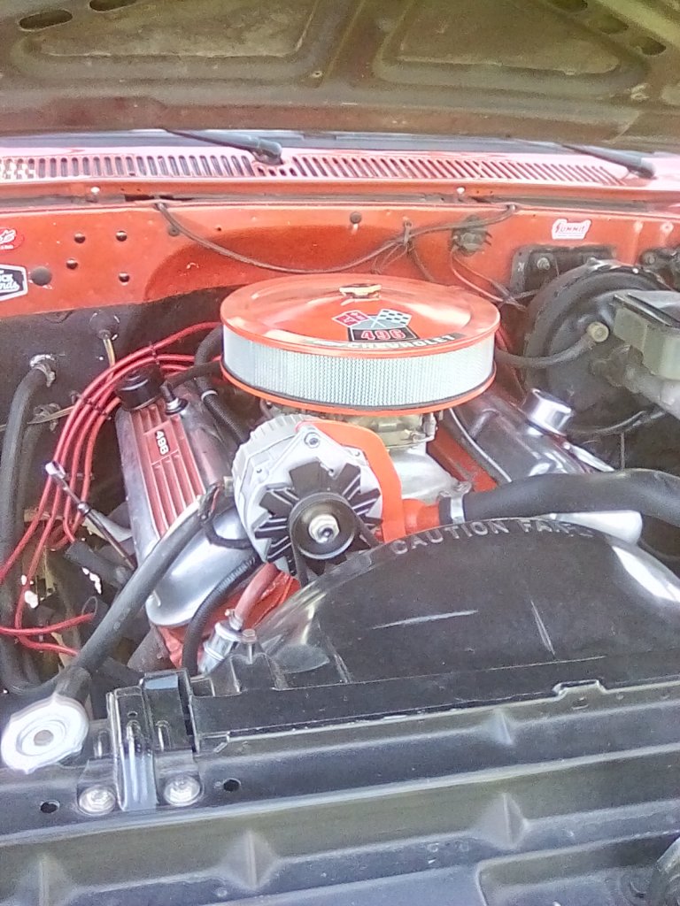

I have a 496. It's an old 76 454 with a Skip White 496 rotating assembly and .060 over. 781 heads, Weiend dual plane intake 750 Holley. This a very happy big block that gets 11 mpg. I work this truck but drive her gently. I would recommend this setup, but I don't do burnouts, or high RPM. This truck has mucho torque and does not need high revs. I'm old guy.....

Under hood...
Nice truck shorty . Ye about the same year as my block . And yes the temptation is there for sure . And yes the skip white rotating assembly is a pretty sweet deal price wyze . Also heard good things from those setups. I am sure it's a torque monster . Just driving my friends 402 . Man it pulls all stick just headers . So yes I appreciate your input very much . A chevelle should have attitude. Awesome truck !

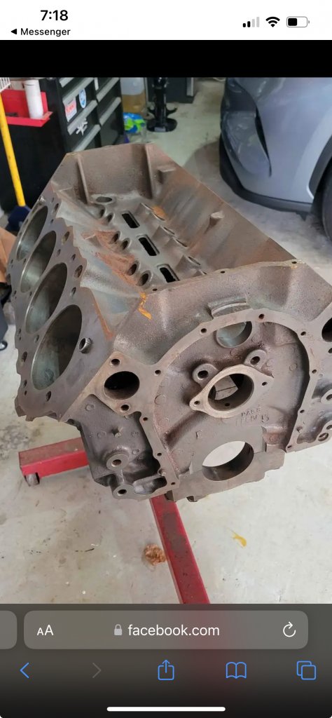

My truck engine has had catastrophic failure from the oil intake tube disconnecting from the oil pump, due to sub-standard brazing by GM.
The engine rebuild project is done, because I cannot afford to rebuild the engine from scratch, requiring a complete re-machine overhaul.

I really appreciate the feedback and advice you all offered me. I was going to have to restore this truck in record time, if the variables were known and it was possible for me to drive it functionally, after new bearings and a new pump.
I cannot reasonably R&R the pump, without machine work, after what I have found out to be the engine issue. 15 miles of the oil intake tube rattling around the crankshaft, before the truck was pulled over, is too long for the internals to handle the damages done, IMHO.
It's a good core and can probably be restored as a good Mark VI Big Block starting point, however I cannot afford to build the big Block from scratch.
I would go with what ever domed pistons you need for 10:1 comp ratio and a hydraulic roller cam with intake duration in the mid 200s at .050".

Your pics do not allow us to see your valley and if it has castings for OEM 454 roller lifters and the spider.
It looks like you have the casting for the cam thrust plate?
The billet cam I have is stepped for the thrust plate...
The timing cover I have available, has 6 bolts and is cast aluminum. It has casting blanks, where 2 additional bolt holes could be drilled, for use with an eight bolt Mark XX.
It has the crank sensor and crankshaft reluctor for timing trigger.
I have the OEM distributor, coil... everything you need for a trigger fired 7.4L, available.
Check your block casting numbers and verify what your cam bearing sizes are.
