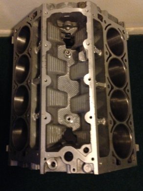

Ls1 5.7 block score!
Now I know I've been all over the map with threads on motors and ideas, until tonight I couldn't make up my mind for sure, well almost sure! I scored this block that was fresh out of a machine shop, but not sure if it's just a stock ls1 bore, or if it has been bored, cylinders look awesome but slightly used so I'm guessing stock specs, but won't know until I get it checked, I wanted to do a 383, but this might be just as easy to pull off budget wise. Or I can sell the block or trade it for a good 350 block or one that has already been bored. Did I get a good deal you think for $100 bucks?

The biggest thing I do not like about the aluminum LS1 is the fact that you can not get much of an over bore on the stock cylinder liners. Seems like .010 is the max, if that. If you need to go bigger than that, the block needs to be resleeved, which gets expensive! If the bores are still within runout specs, hit it with a hone and new rings and go baby!
Did you get only the block for $100? My buddy recently put together a nice 5.3 based LS. He got a short block 5.3 for $50 and had it bored for stock LS1 pistons. He now basically has an iron LS1 that will handle more boost and punishment than an aluminum block. The aluminum blocks only save about 60 lbs. over an iron block. Iron block LS motors are still several hundred pounds lighter than a traditional small block.

I just have the block and main caps and bolts, a buddy had it for a build and then decided he didn't want to do an Ls for his 60s caddy, block looks in excellent shape and cylinder walls are still really nice, I gave him a hundy to help him out with some fast cash, I don't want to build a huge beast, I'd be fine with all stock, or mild, the honing looks good with minor scratches on the cylinder walls so I'm thinking it's just standard bore and has been cleaned up for rebuild, looks as though the cam bearings have been replaced as well or look to be in excellent shape, I'm clueless on Ls motors but I think it's a perfect candidate for a fresh motor rebuild, whether to use or to make a short block to sell to find a 383 project I've been wanting to do

The stock bore of a LS1 is 3.898" (most just call it 3.90" for short). The max overbore is 3.905", though some do 3.902" to be safe.
A good hone job will "bore it out" but I would leave that to the machine shop. If it is still within STD limits, you can use that to build a 383 in the LS block. Look at the Lunati crank and rods, for abt $1200 plus pistons, not a budget build though. If they did a good job and the machining is done, then yeah, good start
My plans are to stick with the 5.3L block and I am thinking about doing a bore to the 3.898" size and use STD LS1 pistons, though I hear the con=rods and pistons do have weak points in them and one should at least go to after market for those anyway
NOTE: you will need new main bolts, should NOT re-use the OEM ones because they stretch.
also check local junkyards for a 5.3L. I got a complete engine, ECU, accessories for $600. Starting with a bare block might seem cheap at first, but buying the "rest" of the engine part by part can easily exceed the cost of just another engine. You can develop an inventory of stock parts from which you can assembly a common package (ie the 5.3L)
