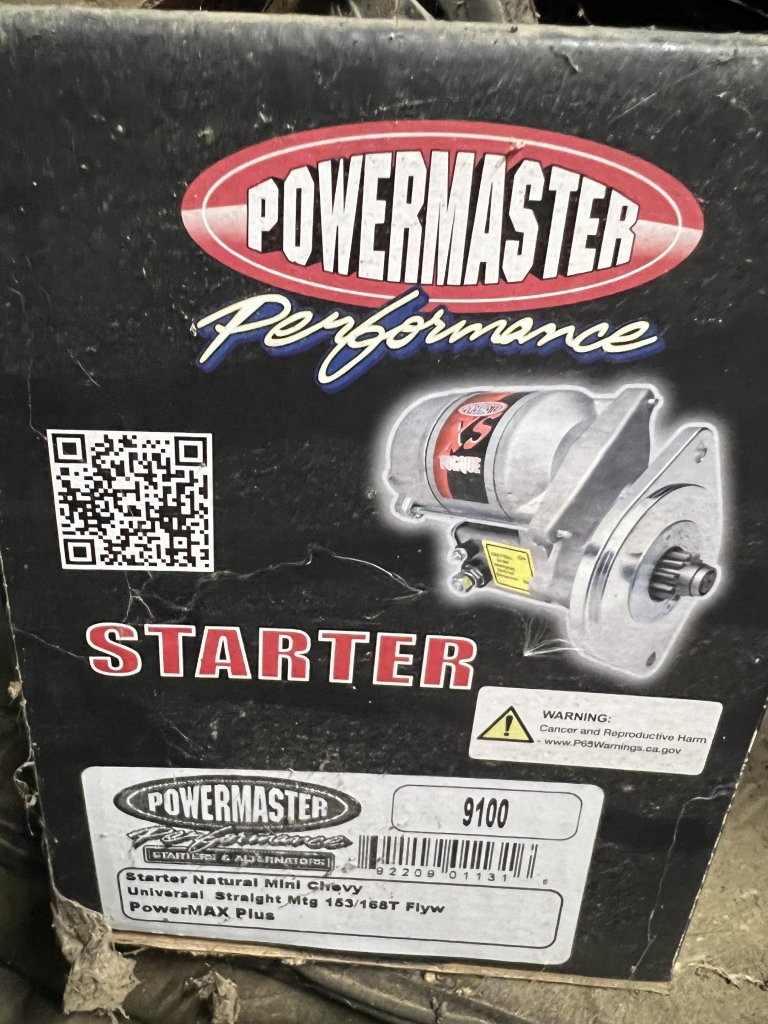

if your looking for a very good mini, pretty tough to beat a Powermaster.
pay a little more but it aint offshore
this is the model i have on my big block

A few years ago, my stock (30 year old) stater was getting bad heat sink. I replaced it with this one and haven’t had a lick of trouble since.
