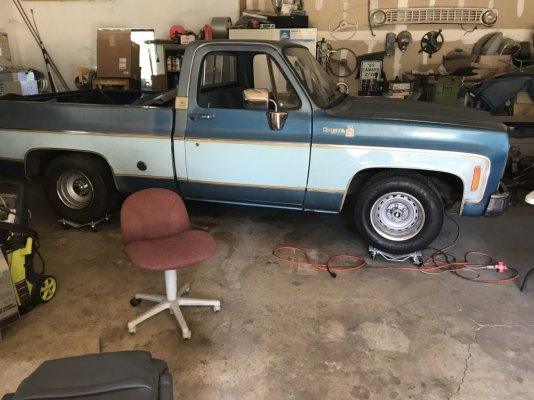

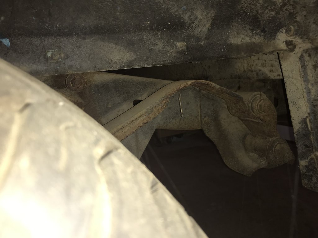

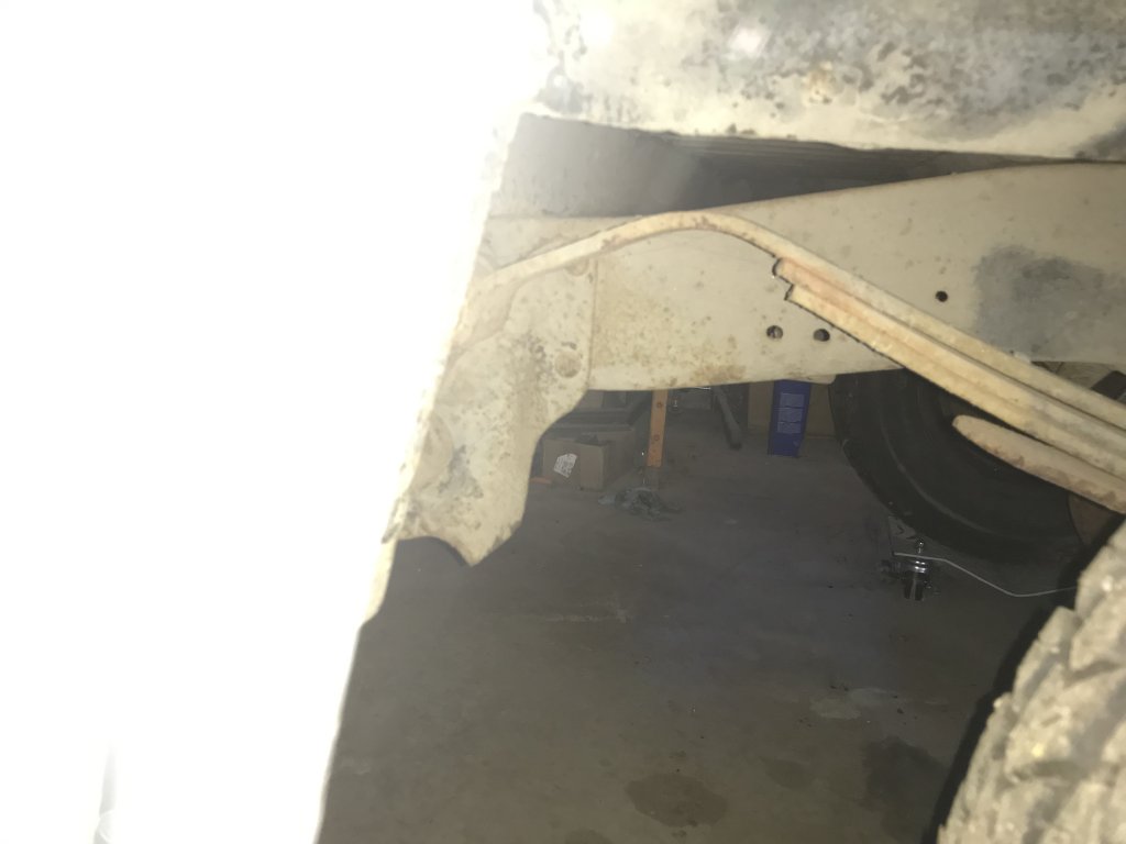

Well I’m almost done with the LS6.0/4l80 swap. I’m just waiting for the back ordered exhaust. Started looking at the height I wanted to lower it and found 4.5“ in front and 4” in the rear would be level and a height I like. That sounded like the rear was lower than normal already. So I started looking. Attached are pictures of the rear springs. I assume is isn’t normal? Did it get over loaded or maybe someone heated them to lower it? Anyone seen this before?

Oh boy, a fools lowering kit. Ditch the springs and do it right with proper spring front mount and appropriate shackle.
That's some sketchy chit right there. You are correct questioning that.

Thanks 1979 c20 I figured that was the case. I purchased the truck as a shell. Glad I never drove it that way. anyone have a recommendation for the replacement springs. I assume I will need to do a axle flip to match the CCP modular 2.5” drop springs and 2” drop coils I have on order.

There's a guy up in Battleground who is on FB that sells square parts that might be able to help get a set easy peasy. Oregon Auto Spring can set you up too, but at a new price. There are guys on here who are helpful too, maybe they can help you get a set, but shipping is the killer, road trip? Shop around and see what is out there, and let us know how it goes.

I did a similar drop...2.5, Modular, 2" spring and flipped rear.
I bought new stock 52" springs for roughly $330 shipped from either RA or SD Spring. However, if I had to do it again, I would have spent a few more and bought 56". In theory, a longer spring would be a better ride. I really don't know if that would work or not on a SB but the frame has the holes and don't see anything that would interfere.
Rather then a flip kit that adds parts and can come loose, I believe you are better off buying some $15-20 perches and welding them on bottom and cutting off the stock. It's cheaper, cleaner, simple, and works like factory.
Something else I wish I did not use was shock extenders. If I could redo, I'd cut off shock mounts and weld on different ones.

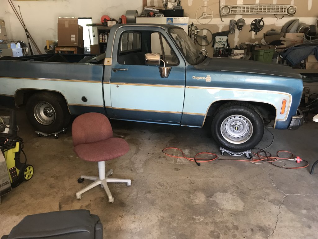

I finished my spring replacement and lowering this week. Used CCP Modular spindles with 2” drop springS and a axle flip in the back. Also picked up the headache rack for $100.

94_6SpeedZ
Nov 30, 2021
Brighton MI
Greg
Which brand lowering springs did you use (I don't know if it matters)? I have the CPP Modular drop spindles also, but I cut the original springs down some and it's not enough. Not sure I want to cut more. Yours sits perfect.
Thanks,
-Greg
1977ShortWide
Jan 26, 2022
19
26
Vancouver Washington
Jeff
6.0
Thanks,
-Greg
Greg,
The springs were from CPP.
FCS6102-2 63-87 CHEVY TRUCK FRONT COIL SPRINGS 2" DROP (PR)
129.00
-Jeff
