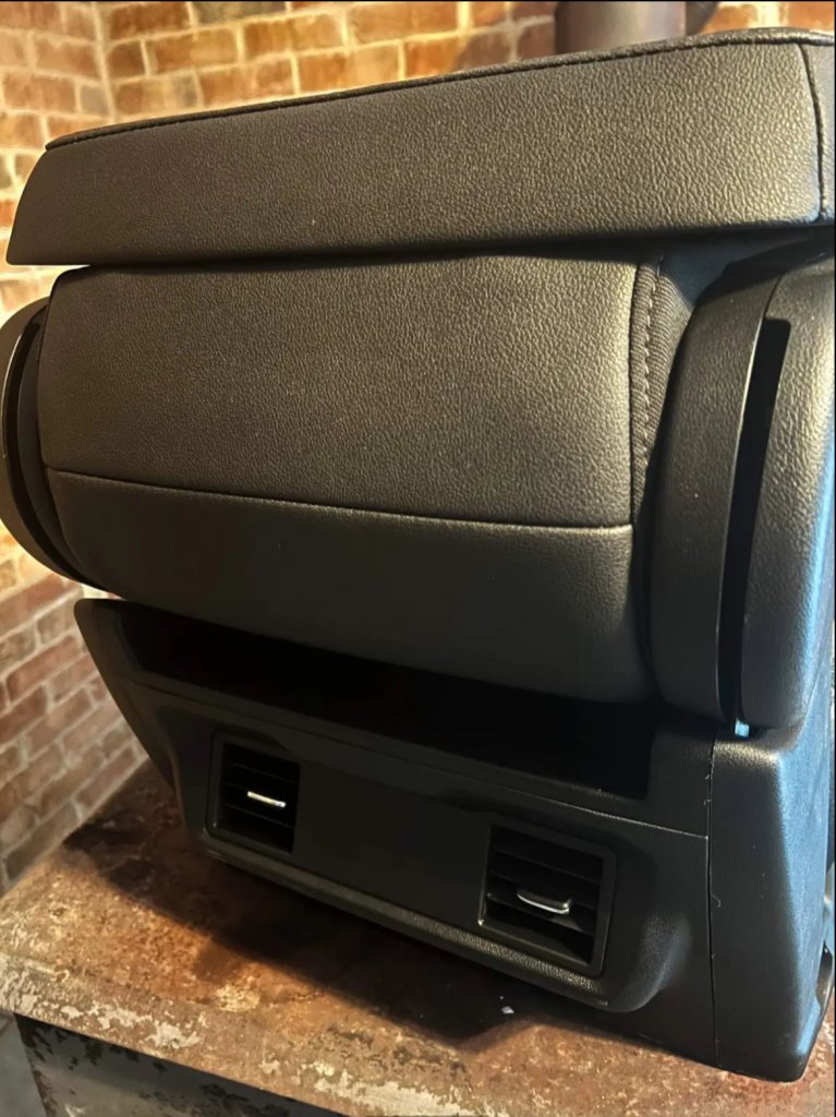

Here is a jumper seat center console with 2 vents. No controls, so could all be cobtrolled on dash (with in-line fan) to turn flow on/off.
Not sure I would necessarily want the jump seat center console, because I need consol to cover floor all the way to dash.
Still need to work through the tcase shifter piece. Would certainly use cable shifter, and placement would be determined after i have console in hand to see fitment.
I’ve got some time on this one. Building truck from scratch, hoping to be in a position to figure out the hvac stuff next spring/summer, but trying to sketch out plan in the meantime.
