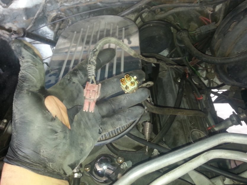

So I pulled out the harnes that goes down to the tranny, through the engine bay area. I have another connector(pinkish red) that was just hanging on the firewall, not connected to anything.WTF!

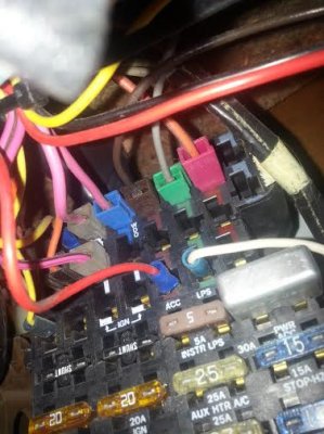

I think I have a gremlin, I traced the wires going through the firewall into th cab, found the brown power wire on the block, checked it with the meter and it gave me 12volts, 30 seconds later I check it again, and theres no power.:banghead:
