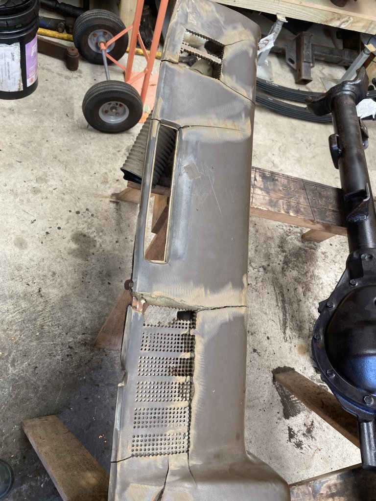

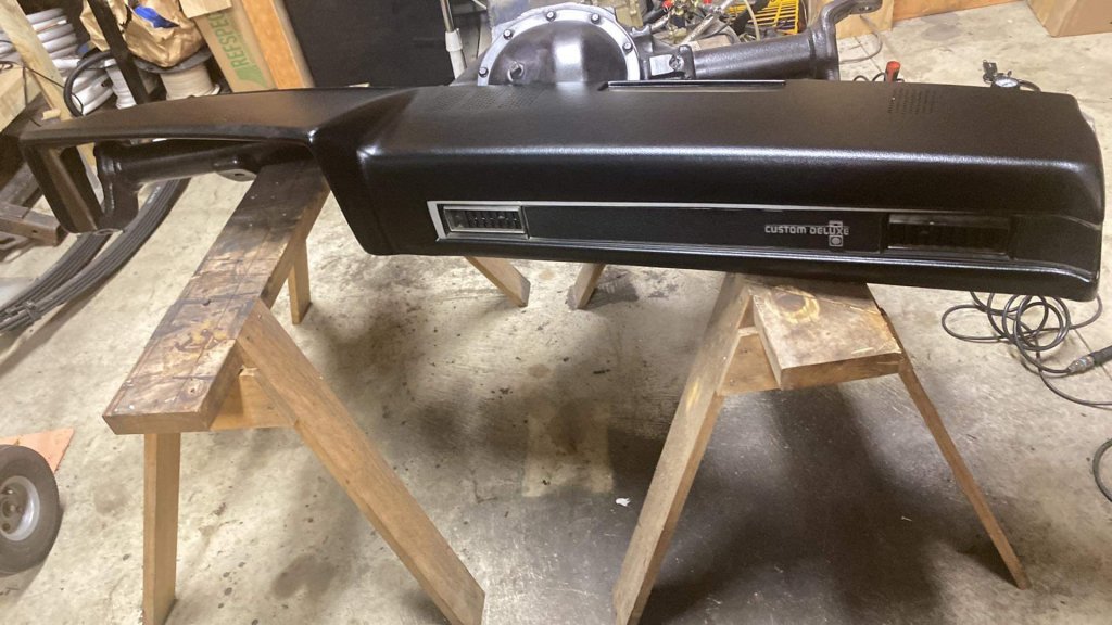

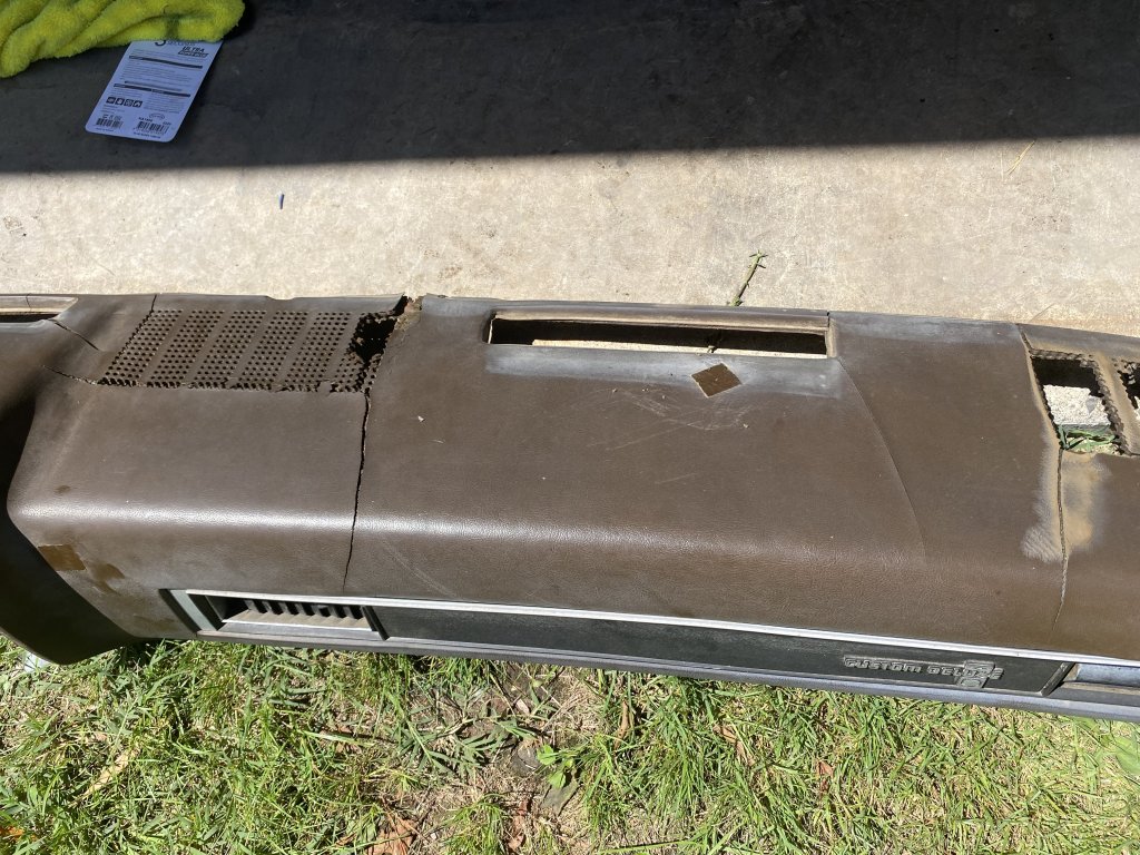

Another cheap option for people is coverlay for around $150. I’m pretty happy with the results. I used a dash filler compound, sanded the dash down before applying the coverlay.

Does it cover the bottom of the driver's side end, that you can only see with the door open?
I've seen some that don't.
