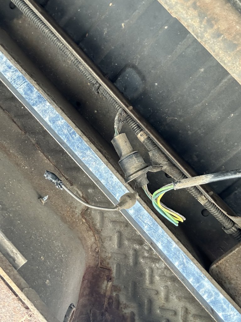

I can take a picture tomorrow but underneath is the bundle from each tail light joined by a plug and the a cut off wire probably for the license plate since the sockets are completely missing for those

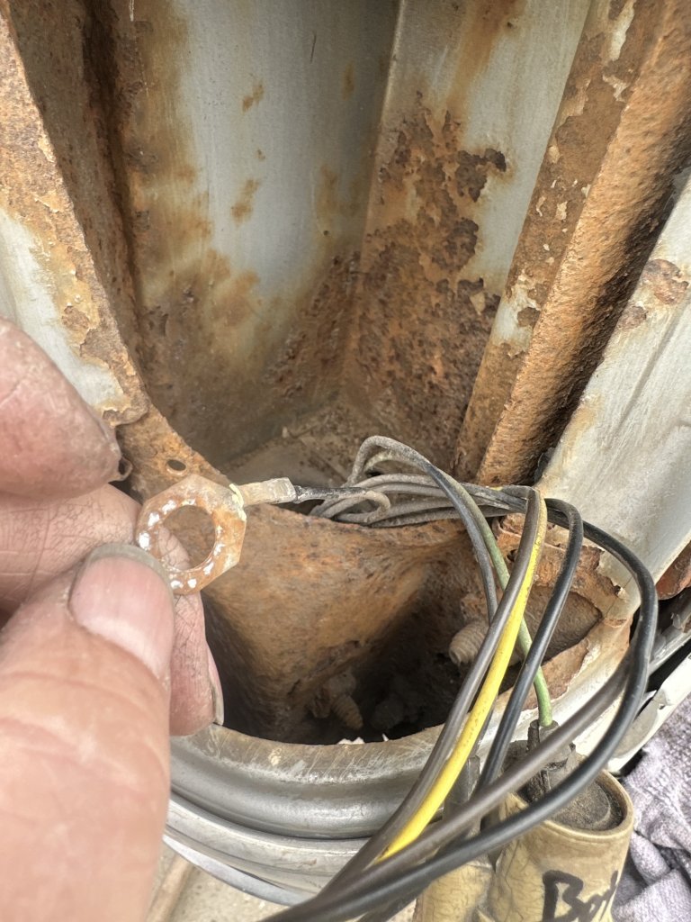

Here’s a pic underneath that look to be the originals,, and I completely forgot to check the ground behind the taillight and it’s all rusted in there and the prong thingy broke off, so will fix that and find somewhere else to ground it
looks like your on to something there!

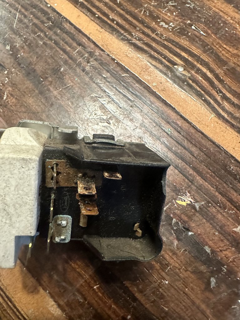

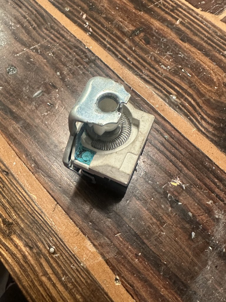

The new led flashers didn’t help anything so I just replaced them with regular 552’s and took out led bulbs and put in regular bulbs, took out cluster for those bulbs and took out my headlight switch it was corroded and two terminals not so great, got a harness on the way

That does not look good. I have heard many stories of problems going to LEDs on an incandescent vehicle. Myself, I refuse to go led. You may be golden after fixing the harness and replacing the headlight switch.

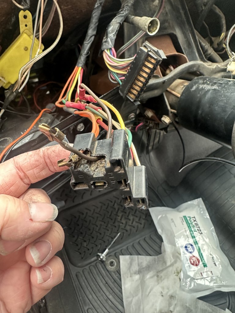

I replaced the wiring harness for the headlight switch since it was messed up and replaced the old switch since it had corrosion. I got the led flasher relay off Amazon, but returned them and bought new ones like the original metal ones. I havent cut on anything yet cause im waiting on license plate lights to hook up too
