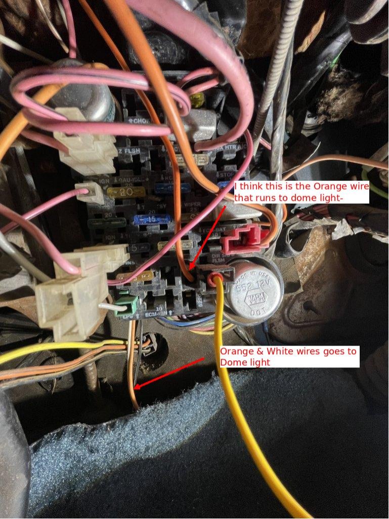

Should both door switches have 2 wires connected to the switch? Driver side had 2 but passenger side only 1.
White wire is ground- both sides should have one. Tan wire is for key left in ign ground (warning ding) - only on driver side.

Likely a broken wire under carpet drivers side.
Orange wire is taking power to dome light. White wire is ground coming back- it is spliced somewhere slightly above the fuse box with the white wire running to door jamb & to courtesy light. From courtesy light the white wire (sometimes changes to wht/blk) runs to light switch to ground it when you twist the pull knob.
The orange wire (I marked in attachment) coming out of the fuse box should meet up with the white wire and head back down under the carpet.(also marked on attachment)
So if your courtesy light is working- it gives you an idea where the problem might be. Like @fast 99 mentioned- very common for it to be broken under the carpet.

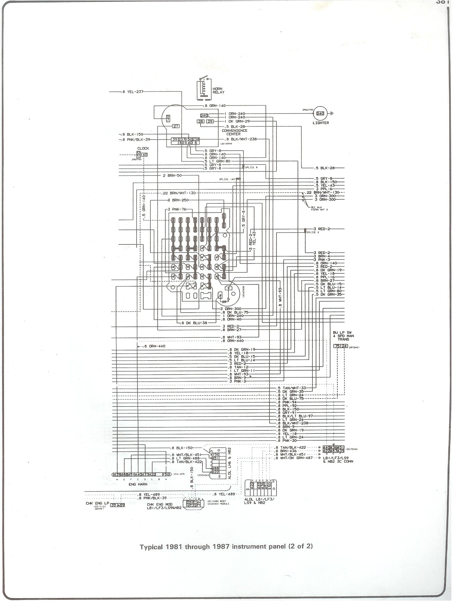

The circuit has to be complete for the light to burn. if schematic is not helping try working from the receptacle to the point of power. broke wire makes sense. Ohms law comes to mind.
Thanks. The white wire from that orange/white pair does in fact run behind the fuse box to above. I can’t see where it goes but assume either the door switch or it’s open ended. There are no courtesy lights installed in this truck.
I also noticed in the owner manual that the clock and dome light is on the same fuse so pulling that fuse today to check it before I pull out seats and carpet.
You shouldn't need to pull out seats. It will run down the side by the driver's door. Usually taking the plastic piece off the lower door jamb is all you need to do to peel back the carpet to see.

here is a wiring diagram:
I have used this site for at least 10 years now all the downloads are OEM manuals
This will get you out of trouble!!
