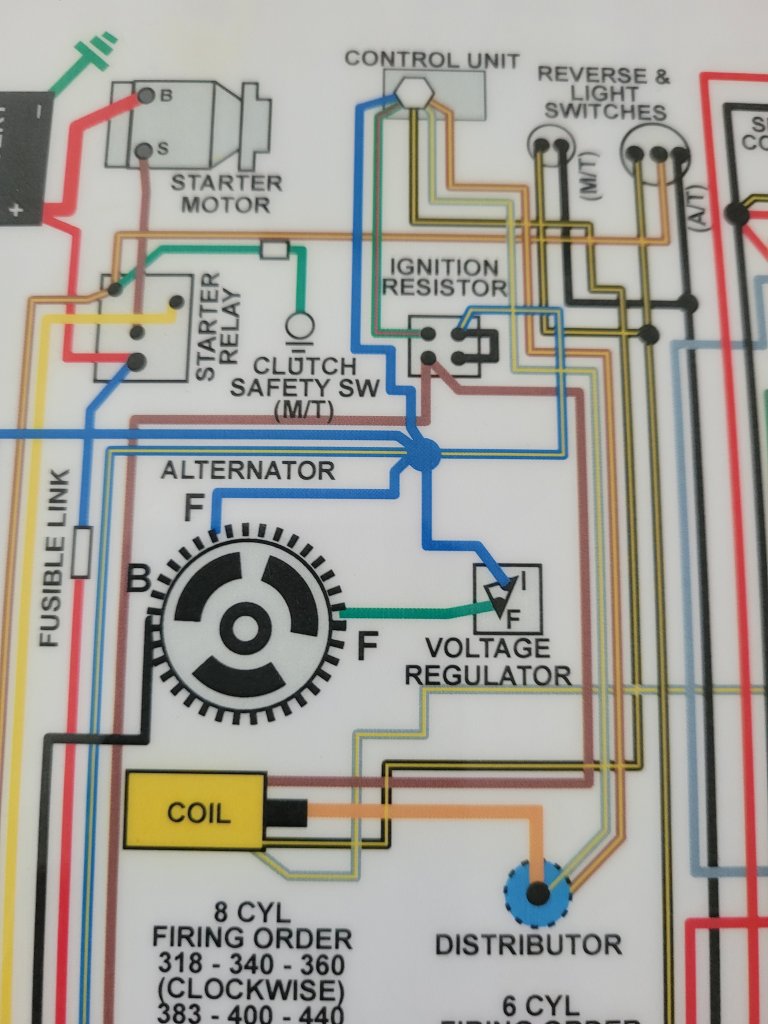

I thought it would be a good idea to let you guys know how this issue got resolved, first off thanks for all the great ideas, it was a learning experience. I have always mistakenly believed that a voltage regulator, regulated the voltage. What I learned is that,(on a Mopar) what it actually does is control the alternator, which in turn, regulates the voltage.
One of the new voltage regulators I had was defective and would keep both fields energized, making the alternator put out max voltage. The race version that I had worked keeping the alternator output at 13.5
I bought a new non-racing period correct voltage regulator at Summit racing and everything works as it should. The needle on the alternator gauge is no longer trying to jump out the passenger side of the car, and the battery is no longer spreading the love all over the engine compartment.

does mopar alts have a feature to "sense" by chance? because for your alternator and battery life, using that circuit to your advantage woud be good here but only if you can I guess

does Mopar alts have a feature to "sense" by chance? because for your alternator and battery life, using that circuit to your advantage would be good here but only if you can I guess
The voltage regulator handles that function, when it senses voltage below a certain point, it energizes the second field, increasing the voltage.
so where in the system is the voltage regulator reading the voltage and determining to increase (or not), just curious

@AuroraGirl Basically the blue F wire on the ALT is hot when the car is running, the voltage regulator monitors the blue wire, when it gets down to a certain voltage, the voltage regulator sends power to the green F wire, energizing the second field in the alternator. It works like a switch, not like a dimmer. Think of it as a two stage charging circuit. The black wire is the output voltage to the battery and the alternator gauge.
So,,,when the battery is fully charged and there is no accessory type load, and both fields on the alternator are energized it puts out close to 17 volts, and cooks the crap out of the battery.
I think I like the Chevy version better with all the parts inside the ALT, one wire seems like a good idea.
