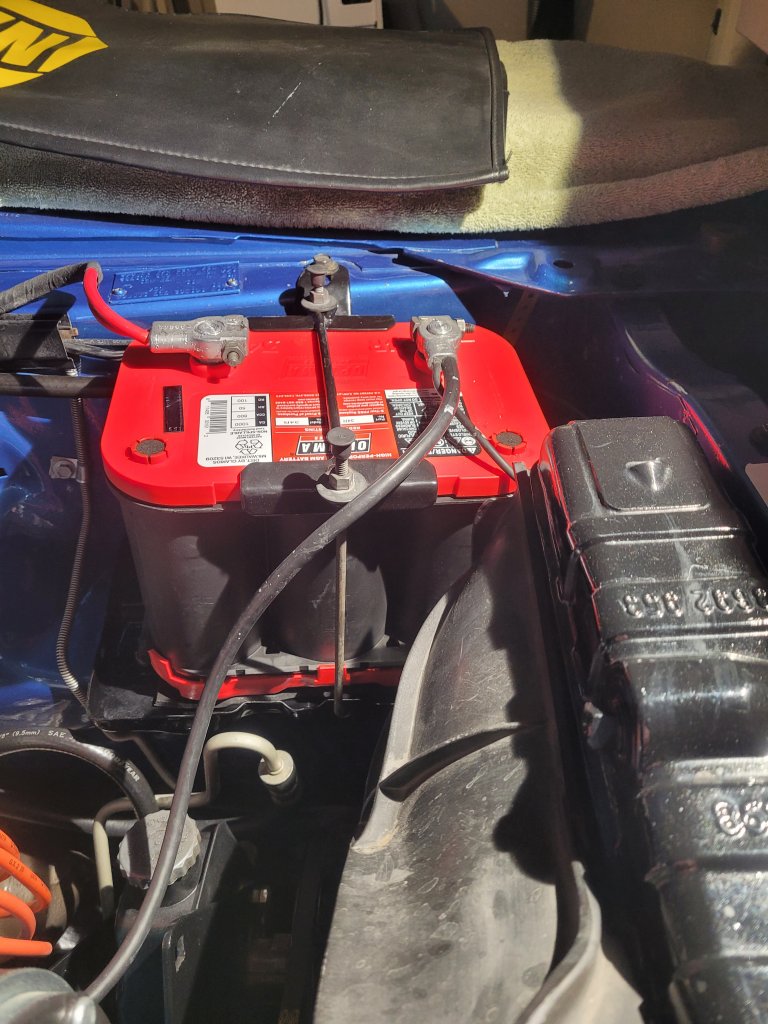

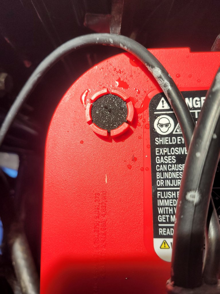

I had to replace the battery in the Charger, 10 years old and started to have issues holding a charge. Figured I would get a quality (expensive) battery. Got a new red top optima battery, put it in the freshly restored engine compartment, and it leaked, about a 1/4 cup. All over the new powder coated battery tray, sprayed on the new radiator and the new engine compartment paint, then dripped on the garage carpet and started melting it, could hear the carpet bubbling.
I had to scramble to get the car out of the garage, douse the area with baking soda, cut out the acid soaked carpet, rinse everything down, dry everything, get the car back in the garage, then return the battery to the store (Autozone) for replacement. Got a new replacement, got it in the car, everything seemed to be fine, and then suddenly.
I just noticed a small amount of leakage on top, no sizable puddles like the last one. These things are supposed to be leak proof to the point where you are supposed to be able to mount them on their side without leaking. I charged it up fully on a new charger with the AGM mode before putting it in the car, no issues, I moved the car out of the garage and warmed it up for less than 5 min, barely lifted the temp gauge, then pulled it back into the garage a couple hours later, still fine.
Just went out to finish up a couple projects and noticed the wet on top of the battery. This is Nevada, if it was water it would evaporate in less than 30 min. Anyone have any experience like this?

Hey WP, it's not leaking, if the battery is getting overheated it will cause what you are seeing. It's evaporation, and a lot of it. So here are some things to check.
First check and see what your charging voltage is, if it is too high it will cause what you see. Also make sure the battery is not deep cycling, in other words, discharging overnight and then having to be recharged. It does not have to completely discharge, just low, and after repeated charging it can also cause what you are seeing here.
Even though AGM's don't have liquid like a lead battery the plates are wrapped with material that is wet with electrolyte. But the electrolyte has water as one of it's components, so if you get it hot it will evaporate and obviously come out the vent.
So check your charging system, and make sure there are not any unusual draws on the battery and electrical system while running or while turned off

Great ideas, thank you. I don't store it with the battery connected, but I did check it and there is no load with battery connected, everything off. I checked my alternator and its putting out 16.4 volts, which seems high. What is normal charging voltage? What is the max, before it starts causing issues?

Normal should be 13.5-14v for pretty much any 12v vehicle, anything more than that is generally an issue. 16.4 is definitely excessive, overcharging will boil a normal battery and cause it not to actually charge (meaning despite putting out all that power, it would be as if you weren't even charging it at all), not sure what it does to the gel in an optima but my guess would be something similar even if it's not full-on boiling. Sounds like you potentially have a bad voltage regulator. That can also cause other systems in the car to get all wonky. Battery aside, too much voltage is no good for pretty much anything, you should look into that before you fry other stuff

Oh believe me it is at the top of the to do list, a spewing battery and a restored and highly detailed engine compartment do not pare well together. I did read that 15 volts is pretty much the max charging voltage, so agree 16.4 is excessive and 3 batteries have confirmed that. I will try the spare voltage regulator and measure again.
Thanks for the suggestions.

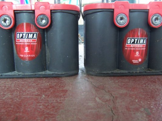

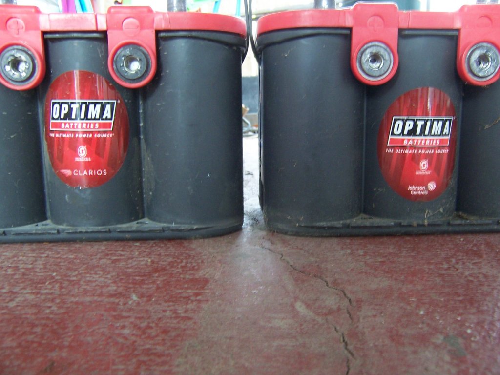

Optimas are made by Johnson Controls. I’m less than thrilled with my Optima, too.
Not today, Clarios. The older ones were made by Johnson Controls. I was happy with the JC batteries.
Interesting, mine has Johnson Controls on the sticker, but was purchased 2-3 years ago. I'm not convinced it's much better than the interstate batteries I've purchased for other vehicles at half the price. Maybe it's just a crap shoot.
