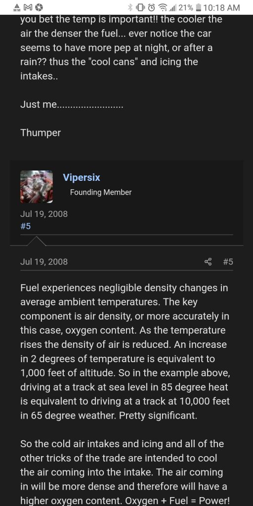

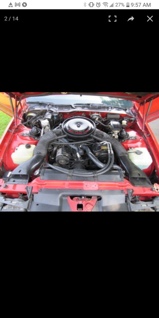

Take off the hood on race night cold intake is worth ponies so is the lost weight and its free. L69 Camaro air cleaner, look its drawing cold air, same reason GM ran Shaker hoods and Cowl hoods, turbos run intercoolers and some racers run cool cans. Cold air/fuel makes more power . There used to be a formula for how much 30 years ago,but I don't remember it, and now all the info is misquided, about injected cars.
