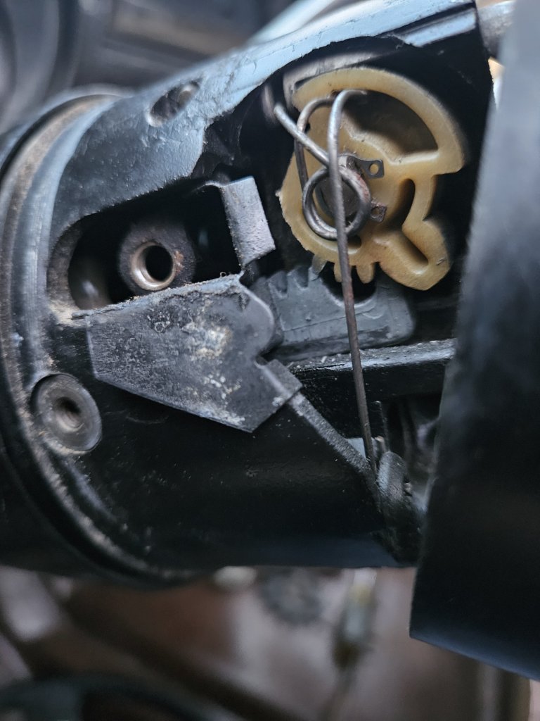

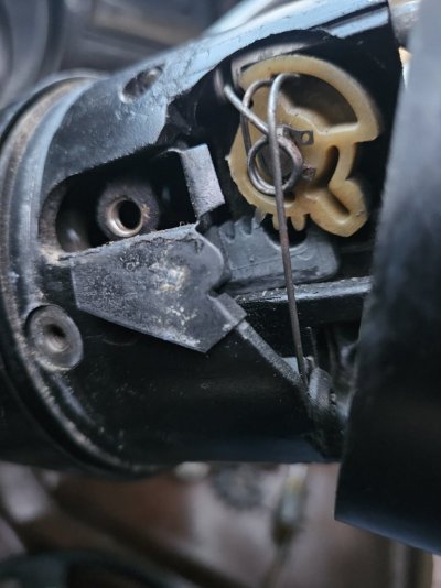

I'm having same issue. I did some investigating and found that this piece is out of place. Not sure what it's called. Trying to figure my next step. Any ideas?
Thanks,
Alex

I found that the ignition sector is broke. I have the piece on order.
Thank you @Jgonick
