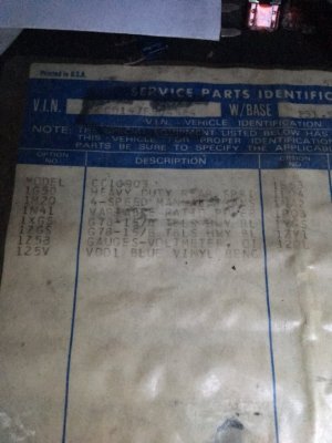

First suggestion I always make is, look in the glove box for your RPO code sheet.
Here is the RPO sheet from my truck. All I see is Variable Power Ratio. I would like to change the ratio to be able to drive 70 on the freeway without feeling like the rear end is going to blow up, or the high rpm's are going to throw a piston.

If your axle is clean, you can reference the stamped numbers on one of the tubes to the list in the reference library. It will tell you the stock ratio that particular axle came with. Rear Axle Code List
You could also easily pop off the diff cover (might as well change the fluid while you're at it) and count the teeth on the ring and pinion and calculate it out that way.
