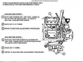

Poly287,
Can you post a picture of the front your carb? Mainly the area where the a/f mixture screws would be?

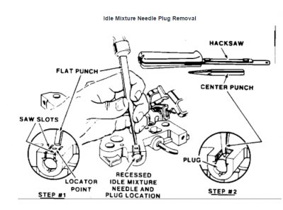

According to my manual these screws are preset by factory, and shouldn't be adjusted unless necessary. Essentially the screws are underneath a wire mesh that needs to be removed to adjust. However, I will post a picture first thing in the morning.

here are my schematics in lieu of a real picture. I will post an on car photo tomorrow.
