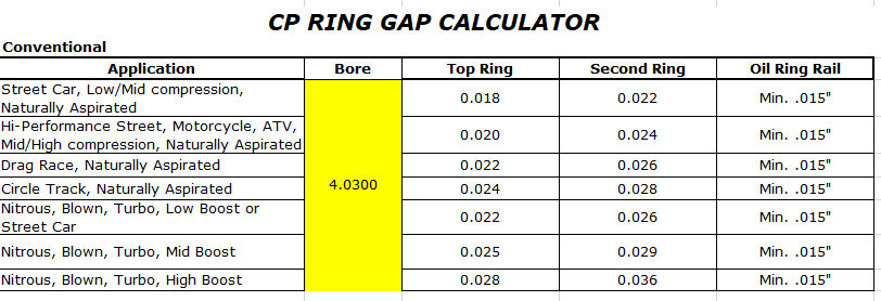

Ok, ok. The old 350 in good shape got 13 mpg. The 355 circle track motor got 11 really fun MPG. The 454 gets about 10-11, puts the other two motors to shame. Wife's 6.2 gets constant 14.5, hauling our 21 ft Imagine trailer it gets between 7 and 9 MPG, has a 6l80. All real numbers from rigs I own. The truck is an 1973 K20, 4:10 with 33" TA, 350 trans 3100 rpm at 70. Swap the 2:73, listen to the input 3:43, or 3:73, (would be my choice). The 4L80e is relative simple, proven, tough, cheap, light years better then the 700R4, (350 with OD, can be built strong.) I have an LS type motor two actually 5.7, 6.0 cast iron. 5.7 can make tons of power, had to get rid of the 98 Camaro, B-4 I killed myself,. 6.0 is the boost queen. Motor cost, is it an issue? Wa St has the highest price for gas in the nation, yeah gas milage is important now. Soooo just remember, any motor you boost will need to be torn down, rings gapped. I build for reliability, motor efficiency, cause an efficient motor gets the best relative gas mileage, not the same as good gas mileage, but the best for the application. Here are 5.3 specs.

I build motors at a local machine shop, Lessons I have learned go big or go home. Get a 6.0 4l80e setup (got mine for $1500 143000 miles Portland OR.). then go see Richard Holdner, and pick a combination.
