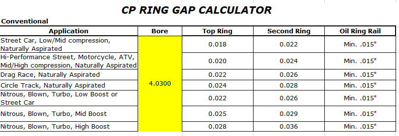

Haven't see anybody mention that any boosted engine will need more ring clearance, requiring teardown, and file fitting the rings. You hear about it all the time, but believe ime, it is a bit tedious. At the shop, we use many different brand pistons, each comes with it's own clearance. Within that set, there are different clearances if it is for example, a marine engine, stock, or boosted. So think what is involved....Remove engine, teardown, ring dissemble, file, reassemble, (hope you don't break a ring.) gasket sets are expensive, as is time. Your rig will be down for a month, (yeah right, more like a year,) and I can see an easy 5000 $ spent. If you do that, trans of choice would be a 4l80e, not the 6l80.
